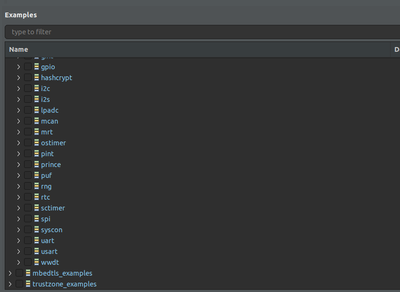

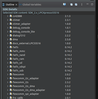

I'm wondering if anyone has encountered the issue of the FatFs example not appearing in the SDK examples. I have downloaded FatFs within the SDK, and I can confirm that it exists in the SDK content. However, I am unable to find it in the list of importable SDK examples. Any insights or suggestions would be appreciated.
SDK content :
The "Import SDK Example" does not include the FatFs example.

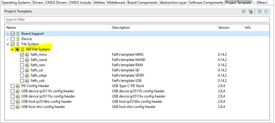

Hi @ahmed007
You can create a project with this middleware clicking on create new C/C++ project... and then selecting the project template or middleware.
