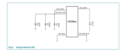

If I'm not using the DCDC converter power stage output pin do I leave it unconnected? Table 4 of 6.2.1 Termination of unused pins does not specify.
Thanks for the help,
Dave

Hello @HPT_Dave
If do not use DC-DC converter, make it as floating, using internal LDO hardware design as below:
Alice
