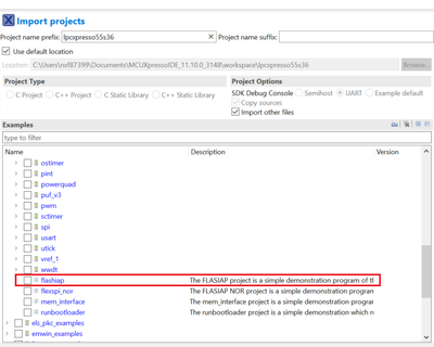

5,592 Views
Harry_Zhang
Hi @ThomasSPana
You can download the LPC55S36 SDK from the Select Board | MCUXpresso SDK Builder (nxp.com).
And you can refer to the flashiap and flexspi examples.
These examples should demonstrate basic flash operations and can be a good starting point for your testing.
