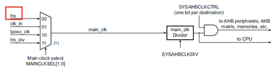

Do you say that the LPC802 hangs when it enters power-down mode even if the watchdog reset event happens?
Anyway, pls configure  to use the FRO as the main clock before you enter power-down mode.
If you still have issue, pls post your project and describes your issue clearly so that we can duplicate your issue.
Hope it can help you
XiangJun Rong

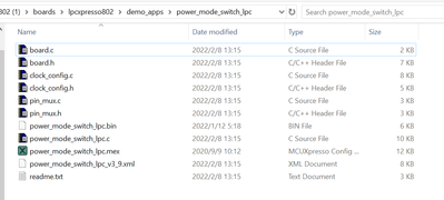

xiangjun_rong
Regarding your question, we have the power_mode_switch example in SDK, pls download SDK package from the link:
https://mcuxpresso.nxp.com/en
For your issue, it appears that you use WKT to wake-up LPC802 from power-down mode, so pls check the WKT counter in debugger and check if the counter changes with time.
