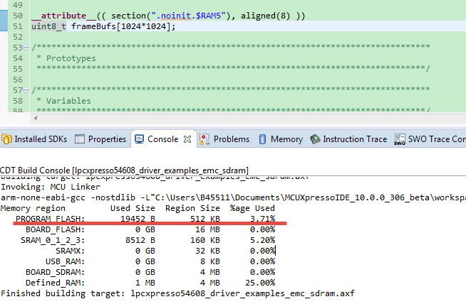

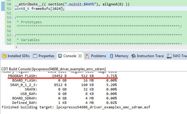

jeremyzhou
Hi Dimitris Sideris,
Please referring to the the method as the following thread illustrates, and after testing, it definitely occupies any space of the flash.
Placing data at an address
Fig 1
Fig 2
TIC

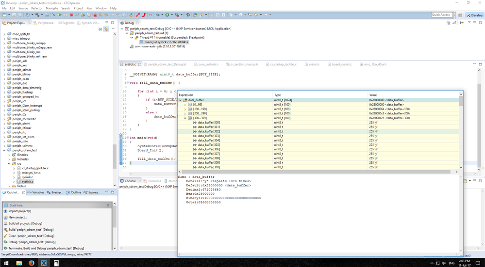

dimitrissideris
Thanks a lot.
After your suggestion i used the __NOINIT(bank) macro and it worked the same as your example.
The issue is that sdram is not consistent.
When i write to the buffer that is located in sdram from 10 to 50 values everything seems ok.
When the array is kind of larger 1024 (not to mention even larger like 32*1024*1024) values in sdram are not the values i assigned.
Actually all values are 255.
example code:
#include <cr_section_macros.h>
#include "board.h"
#define BUF_SIZE 1024
__NOINIT(RAM6) uint8_t data_buffer[BUF_SIZE];
void fill_data_buffer() {
    for (int i = 0; i < BUF_SIZE; i++)
        if (i<BUF_SIZE/2) {
            data_buffer[i] = 0x0A;
        else {
            data_buffer[i] = 0x0B;
int main(void)
    SystemCoreClockUpdate();
    Board_Init();
    fill_data_buffer();
Any clue or idea why is this happening?
Thanks a lot in advance

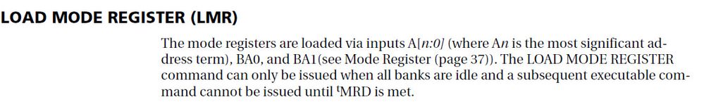

The following is used to execute the LOAD MODE REGISTER command, the mode register is programmed via the LOAD MODE REGISTER command and retains the stored information until it is programmed again or the device loses power.
And you can also can find the corresponding information to modify the dynamic memory configuration parameters in the above structure too.
Fig 1 Load mode register (From the datasheet of the MT48LC4M32B2P- 6)
     pEMC->DYNAMICCONTROL    = 0x00000083;     /* Issue MODE command */

This is what i am trying to do.
I ve been playing around with variations of my sdram timings but below is my "default" configuration.
So far the same reult.
Content stay in sdram only for  a short period of time.
When i try to read them almost right after write content is there.
After about a while (approximately 4,000,000 for loops time)
content gets messed.

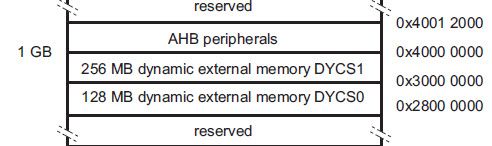

dimitrissideris
Also is it 128 mbit or megabyte?
I see at UM10503 table 412. Memory bank selection
EMC_DYCS0 0x2800 0000 - 0x2FFF FFFF Dynamic 128 MB
I understand that it is 128mbyte. Wrong?
13,856件の閲覧回数

Also where do you find these timings? In sdram datasheet i can olny use timings from a column (-5, -6, -7 ) and not mix them.
2. You said you got wrong Mb and MB. Is it true that DYCS0 of emc can handle 128MByte? My sdram is 512mbit (64MByte).
13,856件の閲覧回数
jeremyzhou
Hi Dimitris Sideris
Thanks for your reply.
1. Is the above timings ur suggestion for my setup?
    Yes, the AC ELECTRICAL CHARACTERISTICS table illustrates these parameters and the I check the Trep again, its value should be EMC_NANOSECOND(64000000/8192).
2. Is it true that DYCS0 of emc can handle 128MByte?
  Yes.

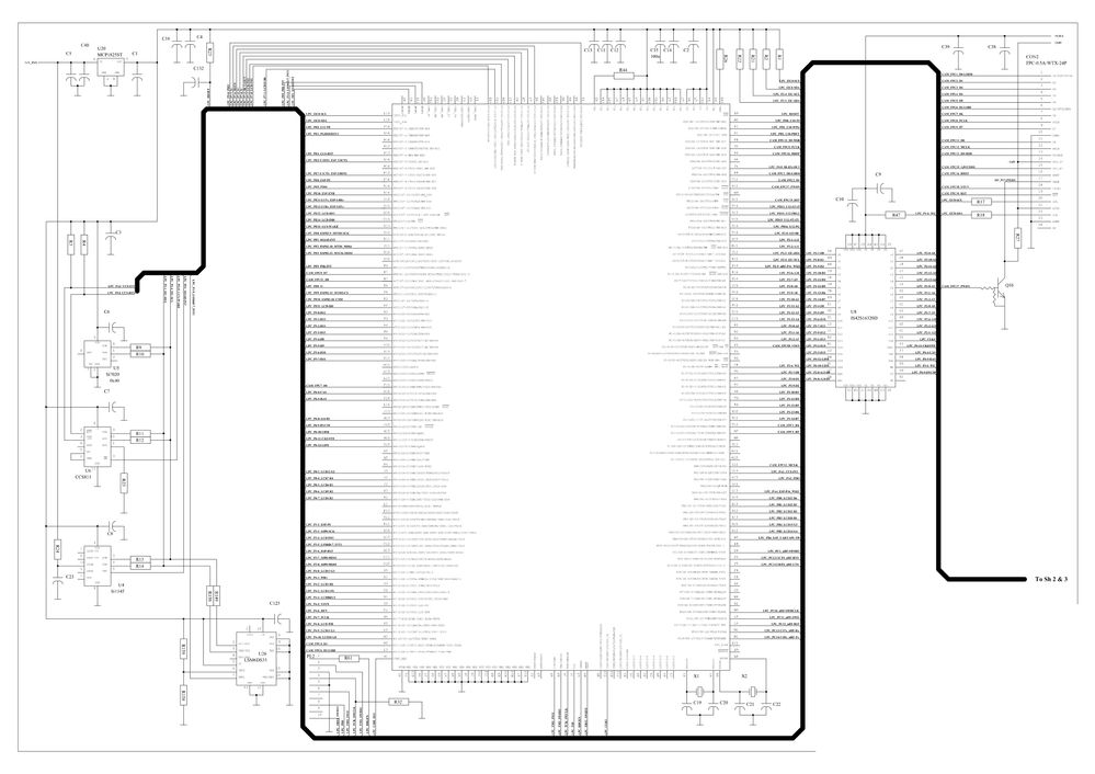

dimitrissideris
Here is the schematic of the connection of the lpc and the sdram

jeremyzhou
It can works on my board, I've attached the testing result and code which you can refer to.
#include "board.h"
#include "mem_tests.h"
#include <stdio.h>
 * Private types/enumerations/variables
#define DRAM_BASE_ADDRESS (uint32_t *) 0x28000000
#if (defined(BOARD_HITEX_EVA_1850) || defined(BOARD_HITEX_EVA_4350))
/* 8MB of Hitex board */
#define DRAM_SIZE (8 * 1024 * 1024)
#elif (defined(BOARD_KEIL_MCB_1857) || defined(BOARD_KEIL_MCB_4357))
//#define DRAM_SIZE (8 * 1024 * 1024)
#endif
__attribute__(( section(".noinit.$RAM5"), aligned(8) ))
 * Public types/enumerations/variables
        if (i<BUF_SIZE/2) {
        else {
 * Private functions
 * Public functions
 * @brief     Main routine for example_memtest
 * @return     Nothing
int main(void)
     MEM_TEST_SETUP_T memSetup;
    uint32_t index;
     Board_Init();
      fill_data_buffer();
     for (index = 0; index < BUF_SIZE; index++)
          DEBUGOUT("\r\n  %x, \r\n", data_buffer[index]);
     while(1)
//     /* Walking 0 test */
//     memSetup.start_addr = DRAM_BASE_ADDRESS;
//     memSetup.bytes = DRAM_SIZE;
//     if (mem_test_walking0(&memSetup)) {
//          DEBUGSTR("Walking 0 memory test passed\r\n");
//     else {
//          DEBUGOUT("Walking 0 memory test failed at address %p\r\n", memSetup.fail_addr);
//          DEBUGOUT(" Expected %08x, actual %08x\r\n", memSetup.ex_val, memSetup.is_val);
//     /* Walking 1 test */
//     if (mem_test_walking1(&memSetup)) {
//          DEBUGSTR("Walking 1 memory test passed\r\n");
//     else {
//          DEBUGOUT("Walking 1 memory test failed at address %p\r\n", memSetup.fail_addr);
//     /* Address test */
//     if (mem_test_address(&memSetup)) {
//          DEBUGSTR("Address test passed\r\n");
//     else {
//          DEBUGOUT("Address test failed at address %p\r\n", memSetup.fail_addr);
//     /* Inverse address test */
//     if (mem_test_invaddress(&memSetup)) {
//          DEBUGSTR("Inverse address test passed\r\n");
//     else {
//          DEBUGOUT("Inverse address test failed at address %p\r\n", memSetup.fail_addr);
//     /* Pattern test */
//     if (mem_test_pattern(&memSetup)) {
//          DEBUGSTR("Pattern (0x55/0xAA) test passed\r\n");
//     else {
//          DEBUGOUT("Pattern (0x55/0xAA) test failed at address %p\r\n", memSetup.fail_addr);
//     /* Seeded pattern test */
//     if (mem_test_pattern_seed(&memSetup, 0x12345678, 0x50005)) {
//          DEBUGSTR("Seeded pattern test passed\r\n");
//     else {
//          DEBUGOUT("Seeded pattern test failed at address %p\r\n", memSetup.fail_addr);
     /* Never returns, for warning only */
     return 0;
Hope it helps.

dimitrissideris
Can you share ur sdram initialization code and process?
I have reached in two colclusions with the so far expirements and tries.
1. Values get written in sdram only for a very short period of time.
If i write values to an array that lies in sdram and soon after write i read the value, content is there.
If i write values to an array, the write sequence completes and then if i try to read values from that array content is not there.
2. If array in sdram is really small everything seem to work fine. If array gets bigger the above symptoms are occured.
Any help please NXP?
