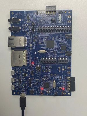

I'm Sukumar . I have some problem on LPC54018 OM40003 EVK . First board same problem occur so new board changed but now this board also same problem occurs.so please anyone say how to solve this problem.
I'm new from MCUxpresso so please anyone give me solution.

Writing 11772 bytes to address 0x10000000 in Flash
1 of 1 ( 0) Writing sectors 0-0 at 0x10000000 with 11772 bytes
( 0) at 10000000: 0 bytes - 0/11772
ProgramPage (0x10000000, 0x22B8, 0x4000) status 0x1 - driver reported driver error - EXTSPI driver rc -20 (0xFFFFFFEC)
Sectors written: 1, unchanged: 0, total: 1
Closing flash driver LPC540xx_SPIFI_SFDP.cfx
(100) Writing Flash ended with an error.
File 'lpcxpresso54018_gpio_led_output.axf' load failure: Ef(49): Flash driver operation gave error.

ZhangJennie
HI
Please follow below photo to make sure all jumper setting is correct.
Try another cable and computer. to make sure the problem is not related with a broken cable or PC problem.
If still can't connect, use LPCScrypt to update on board debug firmware.
https://www.nxp.com/design/microcontrollers-developer-resources/lpcscrypt-v2-1-2:LPCSCRYPT
Try both CMSIS-DAP and Jlink firmware.  Is either of them work for you?

Sukumar_M
Thank you ,i have use another way its better
change Flash Driver SPIFI_SDFC INTO SPIFI_GENERIC one to flash problem solved
