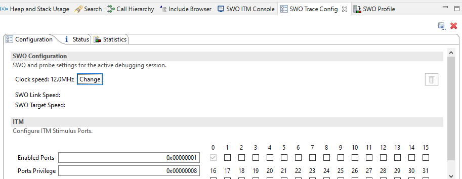

While the target ist running, I go to SWO Trace Config and set clock speed. A clock speed of 12 MHz is detected. See screenshot:
SWO Status is incomplete:
Starting SWO "Resume data display" results in the same error message window as reported earlier:

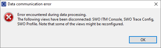

However, clicking on "Resume data display" in any of the SWO views results in this error message window:
Data communication error
Error encountered during data processing.
see screenshot:
