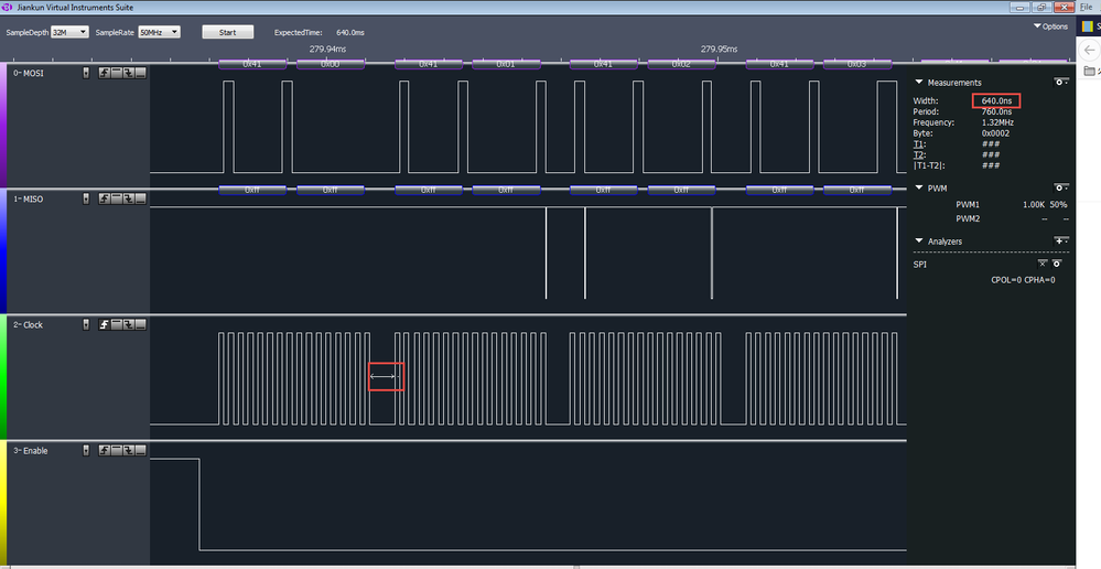

kerryzhou
Hi Chris,
  Sorry for my later reply, I have got your code.
 I have test the periph_spi_sm_poll project, this is the SPI bus:
The time is just 640 ns between bytes, it's not long.
Kerry
6,413 Views
chrispflieger
Here's what I see. D0 is the clock - which each little burst is one byte. D1 is data, D3 is CS.
D6 is a debug pin set inside Chip_SPIM_XferHandler(), which shows that during the seven byte sequence it never exits that ISR and is just running as fast as it can.
This doesn't make much sense - each loop to process a byte is taking 5 us. Should the CPU be able to process it faster than that? I set the clkout to the main clock - it's 94 MHz.
