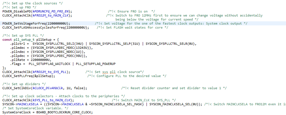

I have gone and checked with the MCUXpresso SDK if its possible to set to 220. It is and it should be possible with the IAR power libraries as well. I have checked the fsl_power.h on both and the same functions are present. Here is what I have done in the configurations. It seems that the reference manual as you stated initially may need to correct that sentence. Keeping in mind that only for the LPC54628 is 220MHz possible.
Could you please try this from your end and see if it results successful as well?
