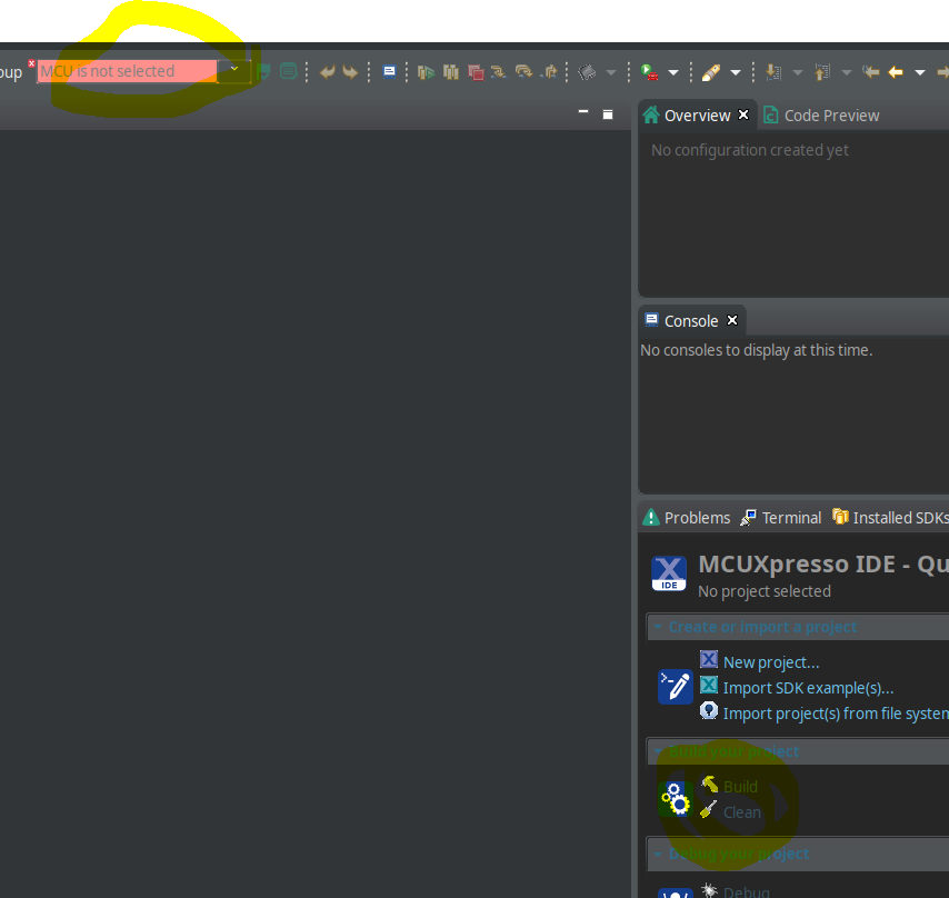

I have set-up a test LPC 1758 work-space and project in mcuxpresso but because there is no target connected to the Link2 debugger I can't go any further.

I am unable to do any pin configuration to the target within the project. One route in gives me the error "MCU not selected", but this should be solved by the mcuxpresso downloading config online (different to the LPCopen SDK?). Another error message also pops up with a dialog "The selected project is not based on MCUxpresso SDK which I guess is because it is LCP open. If this is the case how do I go about configuring the peripherals on the chip? Do I just have to manually do it as per the user manual (chapter 8 and on)? Possible but hardly quick start.

I already have the lpc projects and specifically the LPC1769 zip in my workspace. I start a new project and base it on the LPC1758, the project compiles, but there is "no mcu selected" and the config tool doesn't allow me to do anything.
All ok and compiles with newly created project.
but I still can't set up the peripherals or am I just meant to manual set the registers from defined in the chips user manual?
In addition to this When I reopen the project by opening the workspace and then selecting project from the drop down menu I get this error. This means now the "build" link is greyed out.
and the below error is shown.

Ok, thank you for the images. I now understand what is going on.
The LPC17xx is an older family which is not part of an SDK in addition the config tools provided in mcuxpresso ide, such as the pins tools, clocks tool, peripheral tool, etc are not enabled for this part. So you will not be able to use it as you might have done in the past with other microcontrollers.
In this same manner, the build option will be greyed out, because it is not compatible with working with these windows. You should return to the normal code view by clicking the develop button.

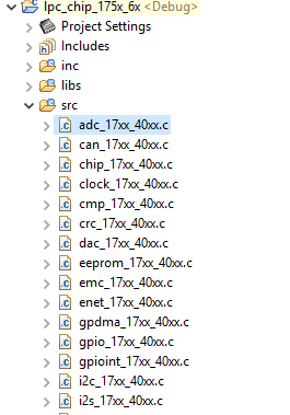

The libraries included in the zip folders I previously mentioned of the LPCOpen already have functions and macros defined that will help you get started. You can follow the example code provided or you can browse these functions within the src folder of the chip folder.
Here for example you have an ACD_init which you can refer to setup this particular peripheral.
Or you can use the ADC example in the same zip LPCOpen folder to base your application on.
