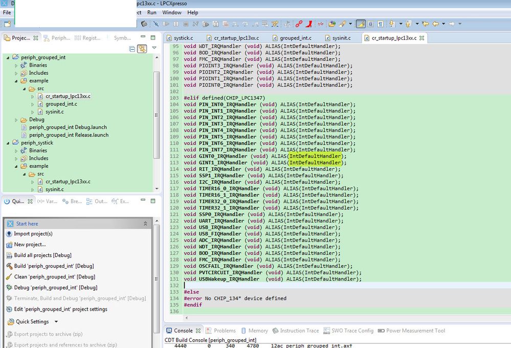

   Actually, in the cr_start_lpc13xx.c, you can find the result:
 ALIAS(IntDefaultHandler);
If you don't define it, it will go to  IntDefaultHandler;

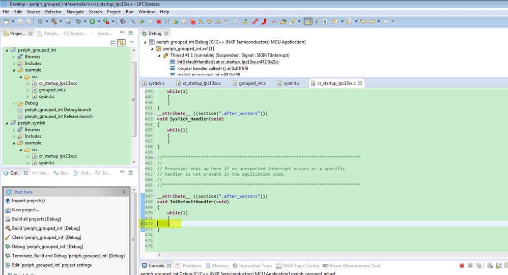

 From the lpcxpresso project, we can get that:
// Processor ends up here if an unexpected interrupt occurs or a specific
// handler is not present in the application code.
__attribute__ ((section(".after_vectors")))
void IntDefaultHandler(void)
    while(1)
So, if the peripherals handler is not defined, when the accoriding ISR is triggered, the code will enter IntDefaultHandler.
Take periph_grouped_int project as an example.
If I comment GINT0_IRQHandler, and when P1_19 is connect 0, the ISR will be triggered, then the code will enter IntDefaultHandler.
So your first post understanding is correct!

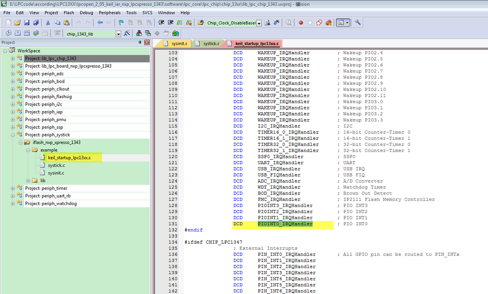

    If you want to enter the interrupt handler, you must add the code with the ISR function name the same as the .s file defined.
  Take an example, if you want to use PIO INT0, you need to use:
void PIOINT0_IRQHandler(void)
//add  your own code.
If you don't write the according interrupt function, the code will have error, it may enter hardfault.

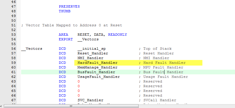

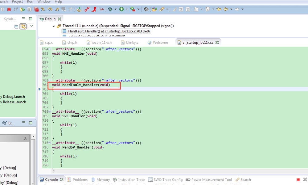

kerryzhou
Hello Prachi panse,
   Just as what I have told you, if the according interrupt handler is missing, the code will enter HardFault_Handler:
Wish it helps you!
Kerry

kerryzhou
Hi prachi panse,
  I don't know what the indeed code you are using, I am using the lpcopen_2_05_keil_iar_nxp_lpcxpresso_1343 code.
 I didn't find the function IntDefaultHandler.
 You can check your project .s file, in the vectors, do you have the IntDefaultHandler vector?
Actually, you don't need to care about the default handler, if you want the code enter GPIO interrupt, please add the according handler, this is the most important thing to you.
