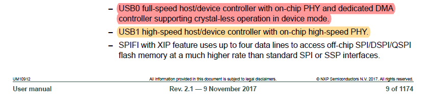

bt_lee
Is it right ?
USB0 controller ---> Full-speed controller
USB1 controller ---> Hi-speed controller
So,
USB0 support crystal-less operation (only in USB device mode, at reset/power-on, DFU, ISP states)
USB1 always require an external 12MHz crystal for entire operation.
UM10912 Rev2.1 page 9

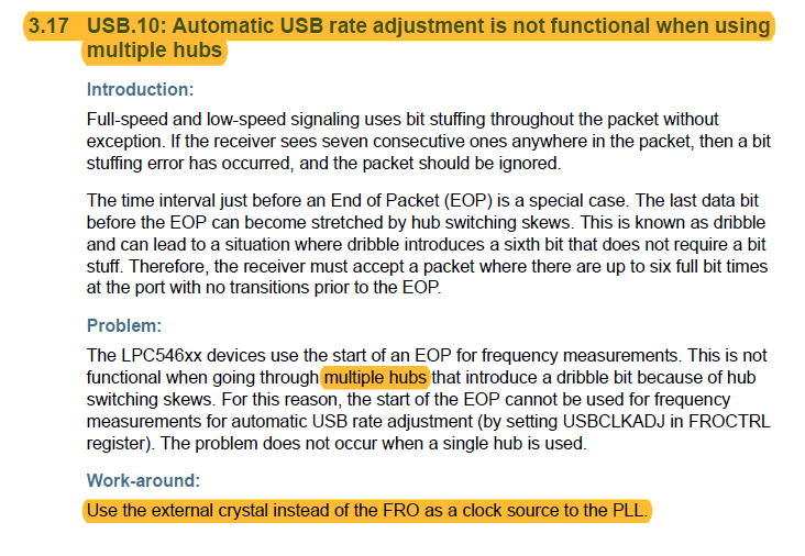

bt_lee
I wrote the previous question because of below.
        Errata sheet LPC546xx R1.7 _ section 3.17 (p.15)

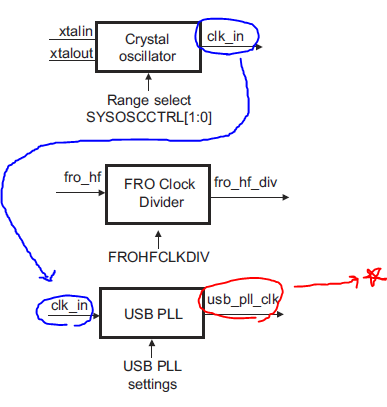

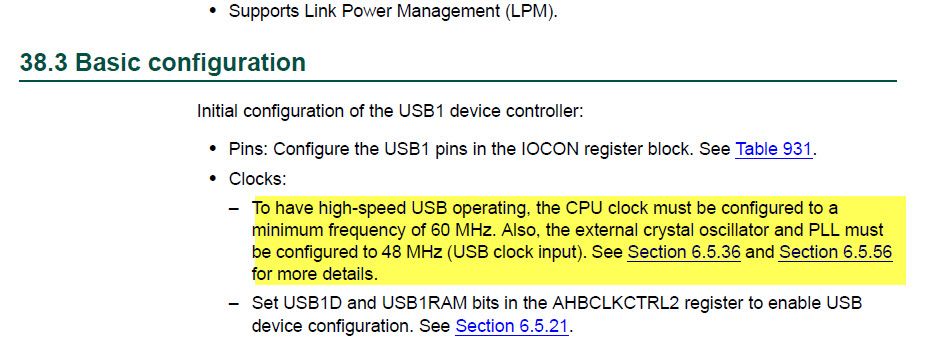

kerryzhou
Hi guanix,
   Please check this information from the user manual,
It means you need to get 48Mhz for USB clock input, so when you choose the crystal, you need to check it, whether it can get the 48Mhz.
You can try to calculate it.
If you still have question about it, please let me know!
Kerry

guanix
Hi Kerry,
Thank you for your response.
I understand that in normal USB1 device operation, I have to write code that enables a CPU clock source that is at least 60 MHz, and I have to enable the crystal oscillator and configure the USB PLL to run at 48 MHz.
But my understanding is that (from chapter 3 of the manual) if I set ISP-2=0, ISP-1=0, and ISP-0=1 at reset, the chip will invoke a built-in ROM bootloader that allows programming flash as USB1 DFU. My understanding was also that this would work even for a completely blank chip with no program in the flash.
The only way this could work as I understand it is that the ROM bootloader, stored in the 64 KB on-chip boot ROM referred to in section 3.1, is itself able to configure the crystal oscillator and USB PLL, without any code on my part.
My question is about what assumptions the ROM bootloader makes about crystal values, if any. If I use a 25 MHz crystal, it is possible to configure USB PLL correctly to generate a 48 MHz output, and this is easy if I am managing USB1 myself. But in USB1 DFU operation from ROM bootloader, my code is not involved, only the ROM code. If the ROM assumes 12 MHz, it would not work.
