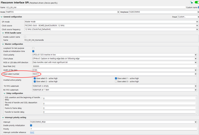

I have 3 targets to communicate with and need 3 CS lines.
These lines are mapped to FLEXCOMM3 SSEL0/SSEL1/SSEL2.
I am using FLEXCOMM3 configured in MCUXpresso Configurater
but the FLEXCOMM3 Slave selection number in Configurater is only selectable for one selection.
I would like to ask how the user can change this selection number
and access 3 SPI devices.
If I set the FLEXCOMM3 Slave selection number in Configurater to Slave0 and generate the code
the Slave selection number is fixed to .sselNum = kSPI_Ssel0 in spi_master_config_t.
This is used as an argument in SPI_RTOS_Init and then again as an argument in SPI_MasterInit inside SPI_RTOS_Init to finally create a handle.

Harry_Zhang
Hi @Seunghyup
Can you try another way?
Manual Control of CS Lines via GPIO
Since the configurator locks the CS lines to a single selection, a practical approach would be to control the CS lines (SSEL0, SSEL1, SSEL2) manually using GPIO pins, which will allow you to dynamically select the appropriate slave device in your code.
Steps:
1. Set up SSEL0, SSEL1, and SSEL2 as GPIO outputs:
• Instead of configuring these lines as hardware-controlled CS lines, configure them as regular GPIO pins.
2. Manually control CS lines:
• Before each SPI transfer, manually assert the desired GPIO pin corresponding to the target slave device (set it low).
• Perform the SPI transfer.
• After the transfer, deassert the GPIO pin (set it high).
Example Code:
GPIO_PinWrite(GPIO, portX, SSEL0_PIN, 0); // Assert CS for device 1
SPI_RTOS_Transfer(...); // Perform SPI transfer
GPIO_PinWrite(GPIO, portX, SSEL0_PIN, 1); // Deassert CS for device 1
GPIO_PinWrite(GPIO, portX, SSEL1_PIN, 0); // Assert CS for device 2
GPIO_PinWrite(GPIO, portX, SSEL1_PIN, 1); // Deassert CS for device 2
This method gives you complete flexibility in controlling the CS lines without needing to modify the SPI initialization for each transfer.

Seunghyup
I would like to change CS dynamically as you suggested.
I looked at your solution but I can't apply the part where you apply CS change.
Your example applies CS change to the sender argument that is applied to SPI_RTOS_Transfer(...), but the prototype of the argument, spi_transfer_t, does not have .sselNum.
The spi_transfer_t structure in fsl_spi.h is as follows:
typedef struct _spi_transfer
uint8_t *txData; /*!< Send buffer */
uint8_t *rxData; /*!< Receive buffer */
uint32_t configFlags; /*!< Additional option to control transfer, @ref spi_xfer_option_t. */
size_t dataSize; /*!< Transfer bytes */
} spi_transfer_t;
Is it possible to control CS in uint32_t configFlags?
