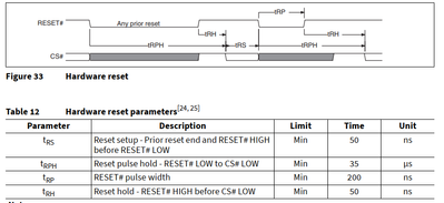

truongnguyen94
Hi Hang,
Thanks for your very specific and detailed explanation.
As we further research on the matter, we come accross this:
According to SFI Flash datasheet, the SPI Flash need tRPH (> 35us) .
We think some delay is needed, our test indicate that we need more than 3 ms to have stabilized spi flash access.
Would you agree with us there is a need of delay in this case?
Best regards.
