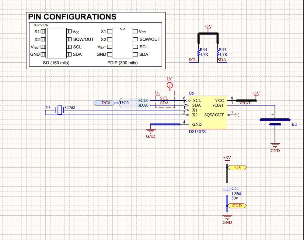

navidansari
hi
i connect ds1307 like this
battery is 3V and voltage on VCC is 5V . i connect another i2c device to i2c bus that its name is 24cxx
24cxx vcc is 3.3 V . because its all open drain so i dont think it would be a problem to connect5 both of them to lpc1768
on keil for lpc1768 i connect to 24cxx and everything work right but when i try to connect to ds1307 its not happening
this is my code

in logic analyzer i just recieve this
why i cant read or write anything to it?
its my main code
     DS1307Init();
     osDelay(100);
     state = DS1307_ReadBuf(0,mTime,1);‍‍‍‍‍‍‍‍

jeremyzhou
Hi navid ansari,
Thanks for reply.
Firstly, I think the hardware circuit is correct, and I've attached a DS1302 driver.
Please refer to it for details.
