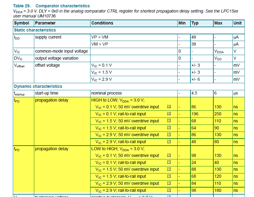

The propagation delay for the LPC15xx comparator is specified in the datasheet only for the higher power setting. What are the propagation delays for the lower power settings?

     1. What are the propagation delays for the lower power settings?
       The propagation delays is in the datasheet:
[1] CL = 10 pF; results from measurements on silicon samples over process corners and over the full temperature range Tamb = -40 C to +105 C.
You can refer to the above propagation delays data.

The screen-shot you include of the datasheet contains only the propagation delays for DLY=0. Other settings of DLY are missing from the datasheet.
