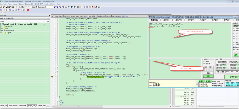

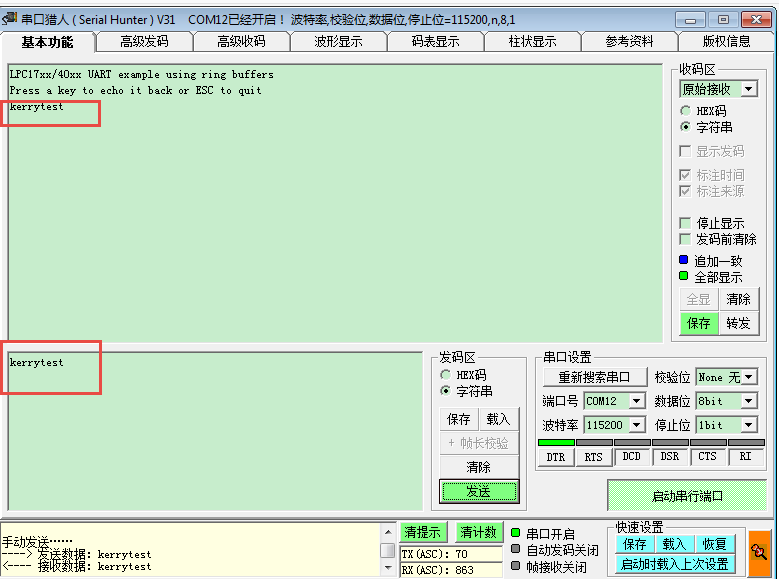

Hi Ken,
   I have test this API function on my EA LPC4088 board, it works.
  You can find, when I use the serial assistant send the UART data to the LPC4088, the Chip_UART_ReadRB()  can get the data, and use the Chip_UART_SendRB send it back.

Answer: No, you don't need to disable the interrupt, actually, interrupt receive the data with rxring:
void HANDLER_NAME(void)
    /* Want to handle any errors? Do it here. */
    /* Use default ring buffer handler. Override this with your own
       code if you need more capability. */
    Chip_UART_IRQRBHandler(UART_SELECTION, &rxring, &txring);
Then use the RingBuffer_PopMul copy the rxring data to the key like this:
bytes = Chip_UART_ReadRB(UART_SELECTION, &rxring, &key, 1);
I have test it, the function works OK, give you another test result, you can find I can use this API receive the data successfully.
