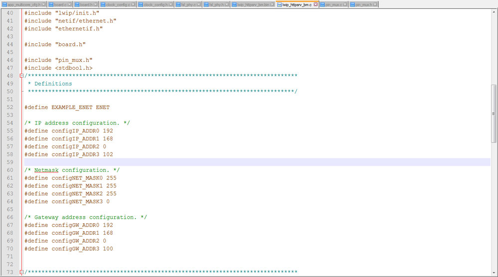

Are you using the SDK? Which demo example are you using?
For example if you are using the httpsrv demo example you can find in the lwip_httpsrv_bm.c the IP address configuration.
