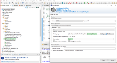

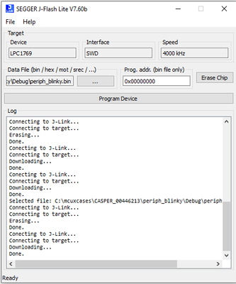

Hope you are well. Regarding your doubt, I already erased and re-programmed this board PNEV5180B that includes a LPC1769, using GUI Flash Tool and also J-Flash Lite to double-check, and I was succesfully able to flash the .bin on Address 0x0000 without any error. One particular observation was that I needed to press Reset button on my board after I flashed program in order to get this one running.
I tried with two different examples from LPCOpen imported to MCUXpresso (freertos_blinky and periph_blinky) and it worked well.
I would like to know if you are using a custom board or which NXP board you are using? My suggestion is to try reproducing this examples to see that everything is working well.

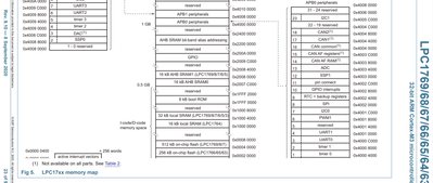

It is a pleasure to assist you. Regarding your issue, as you mentioned, above address 0x400 or higher is the programmable flash memory, because, below this address are the active interrupt vectors as shown in the next image from LPC1769 datasheet:
That is the reason that you saw that error.
Hope this information was helpful, please let me know if you have more concerns.
