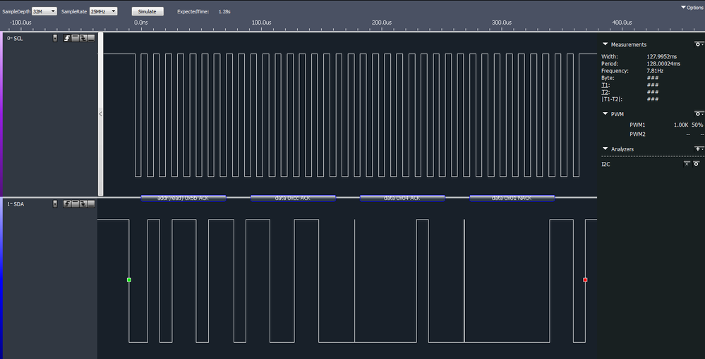

    Now, after you modify the code bundle I2C example to meet your own external sensor demand, do you test the I2C bus wave? You can check the I2C bus wave, when you send the address, whether your slave can give the ACK or not? Whether the address is correct in the I2C bus?
   Take an example:
This the I2C bus logic analyzer wave, you can find when send the slave addr=0x2d, the slave give the ACK, it means the LPC can communicate with the I2C slave side.
So, I highly recommend you test the I2C bus, then associated with your lpc code to test the function, this is will be more efficient.

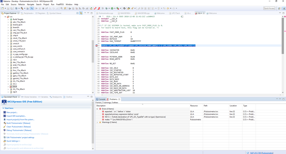

One more question , I have some libraries of my own and I want to use the i2c.h library, what is the right way of including the library , I mean to use them all in the same project, cause I'm having some problems with the IDE and the includes that doesn't recognize other libraries, or when I try to build the project some errors appear in my project that doesn't appear when I build the some .h in the lpcopen project. Here is an example of that:
As you can see, there are 4 errors in that line (which doesn't have any problem when I build the I2C project of the lpcopen library), and I have to manually copy and paste all the libraries in the "src" foulder because the #includes didn't find the libraries (for example the LPC17xx.h).
Thank you a lot for your support Kerry

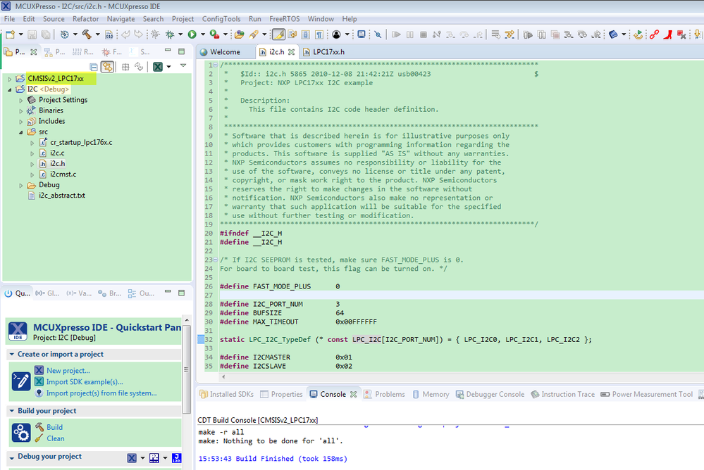

   The I2c wave which I give you is using the Logic analyzer to test it, you also can use the oscilloscope to check the I2C bus wave, but you need to identify the I2C data by yourself.
   About your i2c.h lib problem, it seems you didn't add the CMSISV2_LP17XX in your code bundle package, I have tried it on my side, it builds without any errors.
You can try to import the CMSIS lib, then try it again.
Kerry
