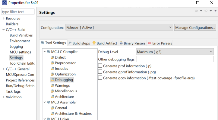

Hi Paul,
Normally debug and release mode use different compiler setting. for example,
- debug use optimization level with O0 while release mode is Os.
- debug mode uses normal debug level while release mode use maximum debug level.
You can modify the setting manually in project setting
You can modify them and try again.

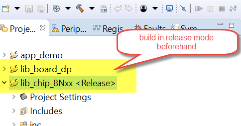

HI Paul,
Please build the two libs with release mode beforehand, then build app_demo in release, there is no error. I have verified it from my side. Let me know how it works for you.

Hi Jun,
Setting the two additional libraries gets the project compiling in release mode but does not resolve the original issue.

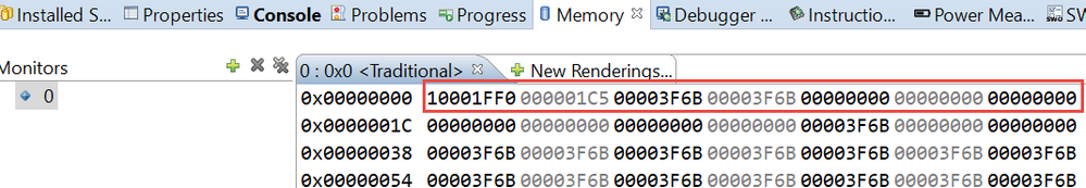

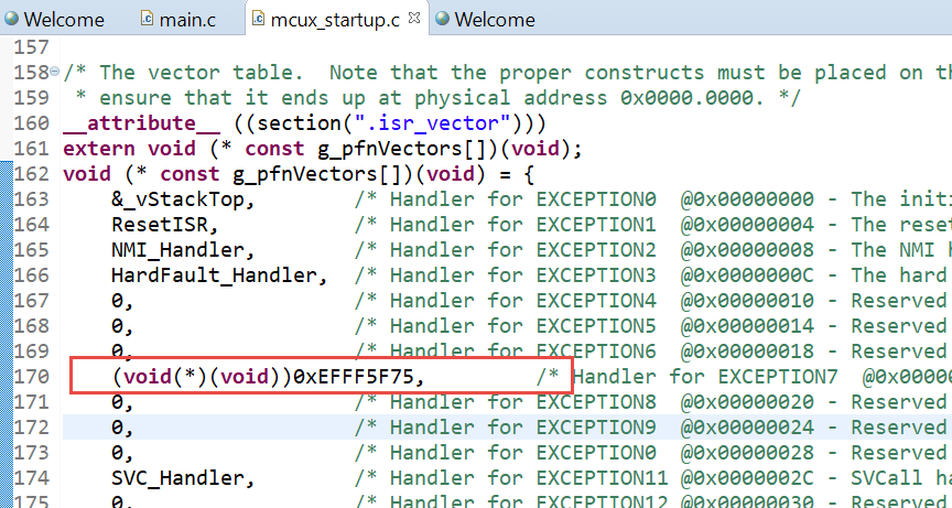

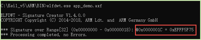

Con Verse's suggestion is right. to get pass the BOOT ROOM checksum, checksum value at address 0x1C need to be filled at vector table. There are at least two methods to get the checksum value:
Method 1. Use Keil tool elfdwt.exe generate checksum value
You need install Keil IDE fist. the tool is under: C:\Keil_v5\ARM\BIN
input command: >elfdwt.exe app_demo.axf
here, "app_demo.axf" is the mcuxpresso demo code generated executable file
After executing this command, checksum will be displayed as 0xEFFF5F75.
Method 2. calculate checksum value by hand
- launch debugger, add first 7 vector values together, then reverse:
0x10001FF0+0x00001C5+0x00003F6B+0x00003F6B+0+0+0=0x1000A08B
0-1000A08B = 0xEFFF5F75
Next, fill the checksum value at address 0x1C in vector table:
build and launch debugger, This revision should fix the problem.
