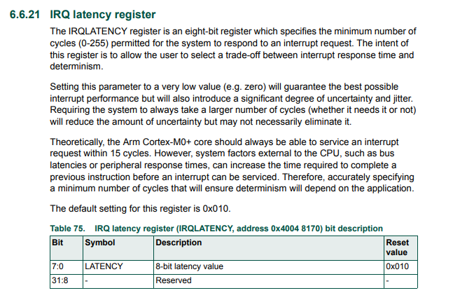

Can someone tell me what is the value of latency that LPC802 can have?

barbaramoraes
Hi, Jeremyzhou!
I am talking about this above. A print of the user manual. I want to know how to use this latency and what it is.
Thank you for your attention

jeremyzhou
Hi Barbara Moraes,
Thanks for your reply.
In general, the response time and stability seems like the two sides of the coin, it's impossible to get both simultaneously. so it makes you balance performance and stability degree and you can configure the register directly.
