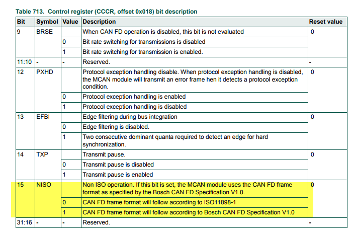

Can fd interface in LPC54000 series MCU is iso version or not?

The MCAN controller is designed to provide a full implementation of the CAN protocol according to the CAN Specification Version 2.0 part A and to CAN FD Specification V.1.0
CAN FD Specification V.1.0:ISO CAN FD or non-ISO CAN FD?

In the control register (CCCR) you can select ISO or Non ISO operation. Please check the LPC546xx user manual, Table 713, for more information.
https://www.nxp.com/docs/en/user-guide/UM10912.pdf
