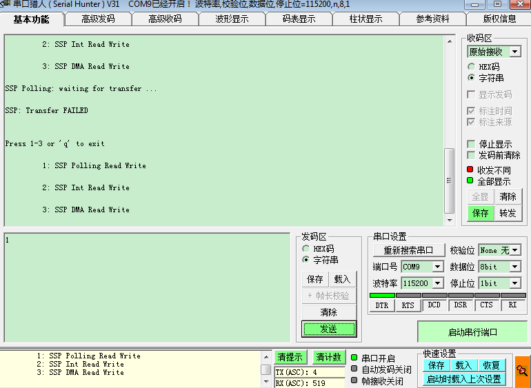

I am using the LC43S67, and try to run the example code periph_ssp on mcuxpresso ide,
after I burn the binary to the target board, I can set the SPI mode and translate method over ttyACM (VCOM),
that works, but there is not signals from SPI clock or MOSI (from J4 in target board).
Do I lost any configure for that?

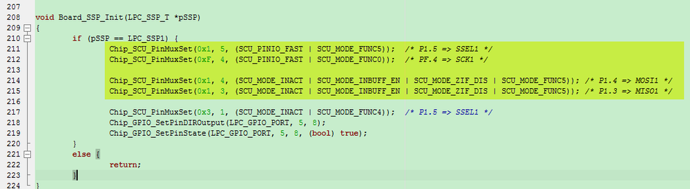

   The lpcopen code is defined like this:
void Board_SSP_Init(LPC_SSP_T *pSSP)
    if (pSSP == LPC_SSP1) {
        Chip_SCU_PinMuxSet(0x1, 5, (SCU_PINIO_FAST | SCU_MODE_FUNC5));  /* P1.5 => SSEL1 */
        Chip_SCU_PinMuxSet(0xF, 4, (SCU_PINIO_FAST | SCU_MODE_FUNC0));  /* PF.4 => SCK1 */
        Chip_SCU_PinMuxSet(0x1, 4, (SCU_MODE_INACT | SCU_MODE_INBUFF_EN | SCU_MODE_ZIF_DIS | SCU_MODE_FUNC5)); /* P1.4 => MOSI1 */
        Chip_SCU_PinMuxSet(0x1, 3, (SCU_MODE_INACT | SCU_MODE_INBUFF_EN | SCU_MODE_ZIF_DIS | SCU_MODE_FUNC5)); /* P1.3 => MISO1 */
        Chip_SCU_PinMuxSet(0x3, 1, (SCU_MODE_INACT | SCU_MODE_FUNC4));  /* P1.5 => SSEL1 */
        Chip_GPIO_SetPinDIROutput(LPC_GPIO_PORT, 5, 8);
        Chip_GPIO_SetPinState(LPC_GPIO_PORT, 5, 8, (bool) true);
    else {
        return;
So, you need to connect the according pins in the board.

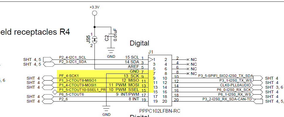

1. Board
  LPCXpresso43s67, REVB
2.lpcopen code
 https://www.nxp.com/downloads/en/software/lpcopen_3_01_keil_iar_nxp_lpcxpresso_4337.zip
3. SSP1 pin

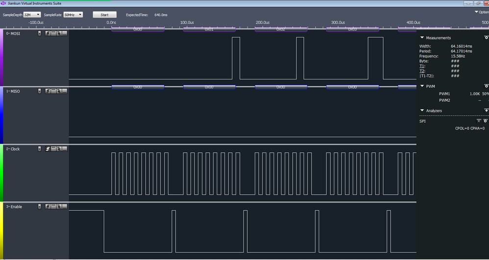

4. Test Result:
I didn't connect the SPI slave, so just MOSI have the data out.
The MOSI works ok on my side.
You modified the code, and you are using the SSP0 now, the lpcopen code are using the SSP1.
Kerry
