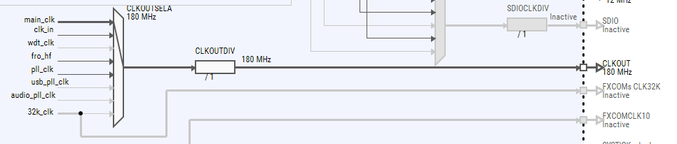

ZhangJennie
HI Jana
We can measure CLKOUT pin to check internal clock.
Using CLKOUTSELA to set the clock source.
Below diagram, main_clk can be measured by CLKOUT pin.
Hope this helps,
Jun Zhang
