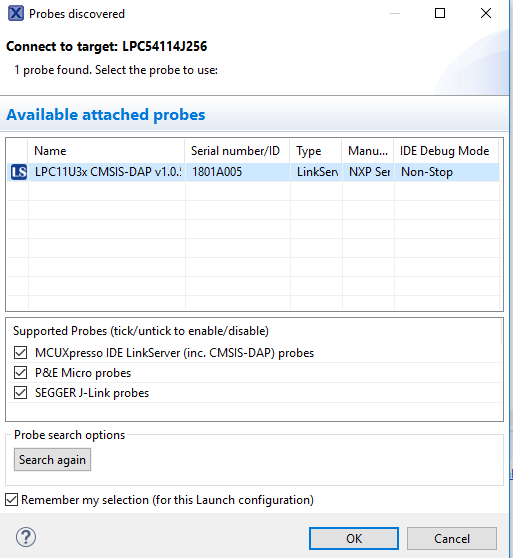

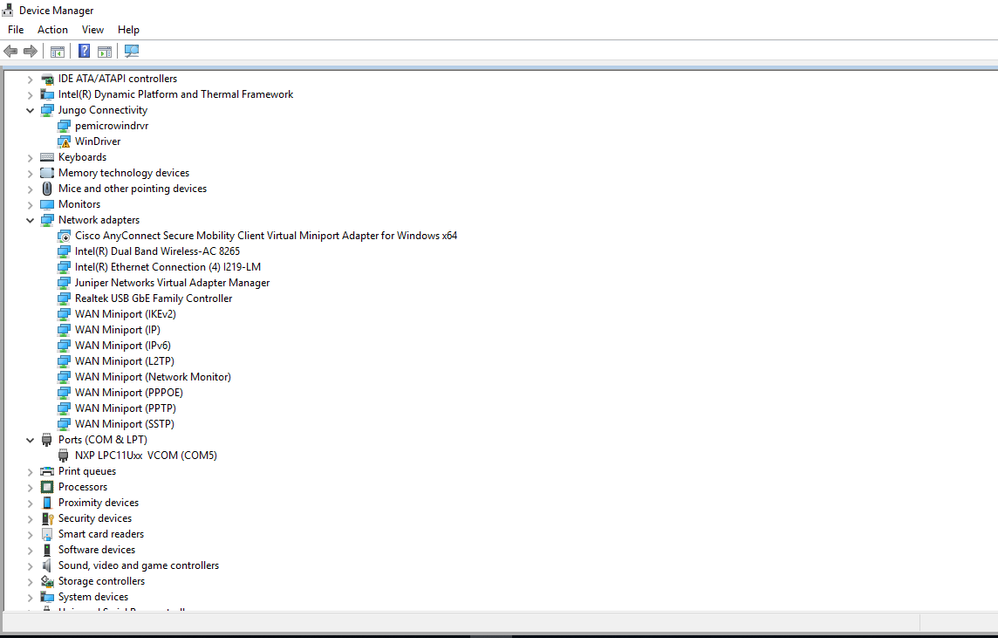

xiangjun_rong
Hi, WangYi,
I suggest you refer to the two figures, I use a board on which the  LPC11U35 CMSIS-DAP chip is embedded. On the device manager menu, the LPC11U35 is enumerated as LPC11U3x CMSIS-DAP device.
I use MCUXpresso IDE tools.
Hope it can help you
