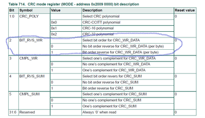

Hello everyone !
I am currently trying to compute CRC32 checksum with a LPC1788.

So when doing this, I am observing a really strange behavior. When the input data is an u32 composed of identicals u8 (example : 0xAAAAAAAA) or "symetrical" u8 (0x12343412 and 0x69686869) the CRC output is correct (for both CRC32 and CRC32-MPEG2).
But when the data input is made of differents u8 (example : 0x12345678), the output is not what I am expecting at all.
Here's a table summing up my situation :
InputMy CRC32 outputReal CRC32 outputMy MPEG2 outputReal MPEG2 output
0xAAAAAAAA0xb596e05e0xB596E05E0x42fc4b290x42FC4B29
0x123434120xb0a58ffb0xB0A58FFB0x9db25e0f0x9DB25E0F
0x696868690xb8e4c55e0xB8E4C55E0xff43f3da0xFF43F3DA
0x123456780xaf6d87d20x4A090E98 0xad37d0560xDF8A8A2B
When looking at this table, I finnally understood : if I want to have the "expected" CRC32, I have to reverse bytes (and not bits) in my input. So for the last line :
0x78563412 in my code (but actually computing CRC32 for 0x12345678)0x4a090e980x4A090E980xdf8a8a2b0xDF8A8A2B
So my question is : why do I have to switch the endianess of my u32 to find the expected result ?

4,144 Views
xiangjun_rong
How about using the init function:
void Reg_InitCRC()
/* Standard CRC32 */
   CRC_MODE = 0x00000032; //instead of 0x36
/* CRC32 MPEG-2 */
//   CRC_MODE = 0x00000002;
   CRC_SEED = 0xFFFFFFFF;
I think that the BIT_RVS_WR should be cleared rather than being set.
Hope it can help you
XiangJun Rong
4,137 Views
erenaud
First of all, thank you for your answer.
I think I already tried that, I will double check this afternoon.
But if I understand the documentation clearly, what BIT_RVS_WR is doing is reversing the bits order (and not the bytes).
So, 0x1234 5678 will be treated as 0x1E6A 2C48, am I right ?
(in binary)
00010010 00110100 01010110 01111000 --> 00011110 01101010 00101100 01001000
