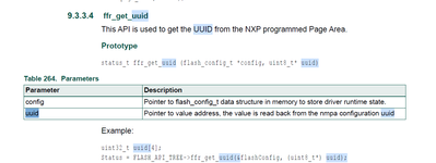

Hello @bressan
Do you mean UUID?
"LPC55S6x/LPC55S2x/LPC552x store 128-bit IETF RFC4122 compliant non-sequential
Universally Unique Identifier (UUID). It can be read from flash PFR region at register
location 0x0009_FC70 onwards."
Alice
2,569件の閲覧回数
bressan
Hi Alice,
I don't search for the UUID, but for the DeviceID, to detect, what kind of CPU is built in my device.
Bernhard
