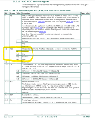

in the user manual for LPC540xx (Rev 1.5) it says Cluase 45 is supported:
in the MDIO section of the ENET module however, there is no mention on how to make the MCU to operate in Clause 22 or 45. There are simply 2 registers, MDIO Address and MDIO Data.
 the interesting thing is that MDIO Address register has field called MOC, which controls the type of operation. In Clause 45 case, it should have value 0x00 for address. in this user manual, 0x00 appears as reserved, making me think that the MCU either does not really support Clause 45 or the user manual needs an updated:
In addition, when i capture the MDC and MDIO signals using a scope, the ST bits of the frame are 01 (clause 22) whereas i need them to be 00 (clause 45). in the user manual there seems to be no way the change these bits.
