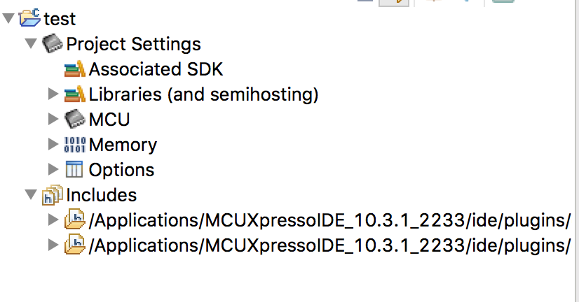

I am very new to the arm cortex world, and I have to work with a LPC5411xx for an internship project. Sadly, I am completely lost, and I dont know how to learn to use this MCU, and I have many questions.
I bought the demo board LPCXpresso 5411xx, but even simple example are difficult to understand. (I am using MCUXpresso IDE).
- How can I create a simple project to begin (File>New>Project>C/C++>C project) without unnecessary file for the demo board ? I have created a C project but I dont have a main.c. In the example, there are many others files that I also dont have (drivers ...), why ?

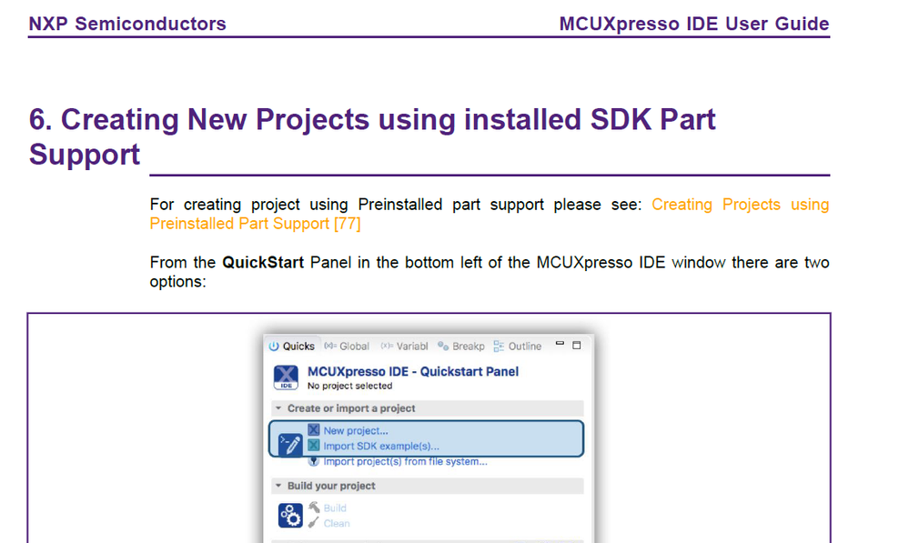

soledad
You have two options with this device:
LPCOpen libraries
MCUXpresso SDK
For LPCOpen
I suggest to check the following document, the document shows an example using lpc15xx device, however the process is the same for the lpc5411x.
https://community.nxp.com/docs/DOC-334959
For SDK I suggest to check the MCUxpresso IDE user guide.
I hope this helps,
Sol
