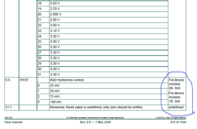

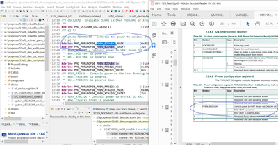

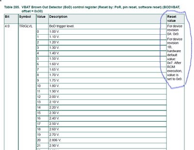

Regarding the default BOD voltage, pls refer to the following fig in UM11126.pdf.
For the default hysteresis,
Regarding the PDEN_BODVBAT, I think it is bit3 in PDRUNCFG0
Hope it can help you

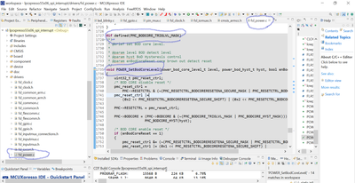

BTW: about the picture you showed a while ago (about the PMC_BODCORE_TRIGLVL_MASK  in fsl_power.c):
You are aware that fsl_power.c is empty in the SDK, we only have the fsl_power compiled library?
But from the picture you showed I guess we can just remove the
#if defined(PMC_BODCORE_TRIGLVL_MASK)
right?

Regarding the default BOD voltage:
You're referring to UM11126, which is for LPC55S6x/LPC55S2x/LPC552x.
But I'm using LPC55S16, which is in UM11295.
Also you're referring to VBAT BOD, but I'm asking about CORE BOD.
Anyway, I don't need to use CORE BOD (ans also found were the defaults are mentioned (below Table 338)
Regarding the PDEN_BODVBAT:
Again: you're referring to VBAT BOD, but I'm asking about CORE BOD.
I also noticed that PMC_BODCORE_TRIGLVL_MASK must be defined to be able to use POWER_SetBodCoreLevel, while there is no documentation about this MASK.
So to me it looks like Core BOD should not be used (configured), right?
BR, Jan Pieter

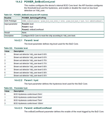

xiangjun_rong
I am sorry for referring to wrong user manual.
Pls refer to the POWER_SetBodCoreLevel (power_bod_core_level_t level, power_bod_hyst_t hyst, bool enBodCoreReset); function, as you see there is not so-called PMC_BODCORE_TRIGLVL_MASK, if you call the function, you can set the voltage level and hysteresis to trigger Reset when the core voltage is less than a threshold.

janpieterderuit
Hi XiangJun Rong,
thanks again for the quick reply, really appreciated!
I know the function POWER_SetBodCoreLevel is described as such in the User Manual.
But in the SDK, in fsl_power.h, the declaration is:
 * @brief set BOD core level.
 * @param level BOD detect level
 * @param hyst BoD Hysteresis control
 * @param enBodCoreReset core brown out detect reset
void POWER_SetBodCoreLevel(power_bod_core_level_t level, power_bod_hyst_t hyst, bool enBodCoreReset);
#endif
So as long as PMC_BODCORE_TRIGLVL_MASK is not defined (which isn't from the SDK), the function is not available.
I was curious, so I tried to use the function by just defining PMC_BODCORE_TRIGLVL_MASK in the makefile, and it builds.
So (at least) libpower_softabi.a is build with this define set.
13,869件の閲覧回数
