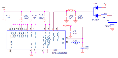

we have an RTC application with an LPC55S16, where we have a backup battery connected as discussed here:
https://community.nxp.com/t5/LPC-Microcontrollers/Recommended-circuit-for-RTC-Battery-backup/m-p/998...
So VBAT_PMU is powered by normal power-supply and backup battery, both through a diode.
We also want to use the BOD functionality (RESET by BOD).
We initially configured the VBAT BOD (using POWER_SetBodVbatLevel).
But looking at the power domains schematic in the linked post, and also table 313 inthe user manual, VBAT BOD is in the AO power domain, powered by VBAT_PMU, and thus the RTC backup battery.
So this will never trigger the BOD (on our specified power level).
Or am I wrong?
The other option is the CORE BOD.
But this is on a completely different voltage level, so no (easy) relation with VCC.
I suppose we just keep the defaults, but I have some questions:

janpieterderuit
Hi XiangJun Rong,
I have been measuring the BOD behavior on our board, and what I see is not what you are saying.
This is (part of) our schematics for the power supply of the LPC55S16 (where VCC = default 3.3V):
(based on https://community.nxp.com/t5/LPC-Microcontrollers/Recommended-circuit-for-RTC-Battery-backup/m-p/998...)
Now when I set the VBAT BOD Threshold to 2.6V (with Reset), the device actually already resets when VCC is 3.0V.
When I set the threshold even lower, the device only resets when VCC gets below 1.6V.
So I tried what happens when I disconnect the battery (so VBAT_PMU is only powered by VCC).
The device now also resets @3.0V when threshold is 2.6V.
But now when I set the threshold to 2.2V, the device resets @2.6V.
So I started measuring the VBAT_PMU voltage level (as it will be 0.4V lower due to the diode), and there I indeed see the voltages associated with the threshold.
Then I shorted the diode (connecting VCC directly with VBAT_PMU).
And then I see resets at expected VCC levels.
So my conclusions:
  • VBAT BOD monitors the VBAT_PMU, not VBAT_DCDC as you stated
  • In the original circuit (with battery) the battery keeps the VBAT_PMU voltage level at at least 2.6V, so it will never reset due to VBAT BOD (the reset at 1.6V is probably due to a Core BOD reset)
Can you confirm this?
If this is indeed the case, the VBAT BOD cannot be used in combination with an RTC battery setup, right?
So then we should use the Core BOD, but as mentioned before, it's not accessable from the SDK...
Thanks in advance.
BR, Jan Pieter de Ruiter

janpieterderuit
Hi XiangJun Rong,
thanks again for your quick reply.
Yes, I saw that the Usermanual also says BOD monitors VBAT_DCDC.
But my measurements clearly shows that is not true.
Or am I doing something wrong?
As a matter of fact I did the testing with 2 variable power supplies, as the battery on the board was already empty.
Our HW guys are looking into it, but it seems VBAT_PMU draws a (relatively) lot of current...
All together it seems like a (battery backed) RTC solution is not possible with the LPC55xx, so we'll have to look at an external RTC module (quickly, as we are running out of time).
So please let us know as quick as possible whether a battery backed RTC is still possible with the LPC55xx.
