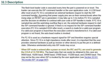

We refer to the document "UM10360.pdf" LPC176x/5x User Manual 32.3 Description.
There is a description "When entering ISP mode after power-on reset, IRC and PLL are used to generate 14.748MHz CCLK", as shown in the figure below.
When P2[10] is pulled low, CCLK is set to 4000kHz, after using SWD IAP programming, power-on reset again, will it affect the programming result?
Is it feasible to set CCLK to 4000kHz? Do you have a recommended setting?

xiangjun_rong
I have checked the data sheet of LPC17xx, but I have not found out the spec of the required CCLK frequency when you call the IAP function.
How about configuring the CCLK as 14.748MHz using PLL before you call IAP function?

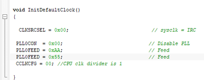

How about that? I have a idea.
After power cycle, initial the system clock to default 4Mhz in my "ram application"(run app in lpc1768 ram), whatever device into application mode or ISP mode.
I can make sure that the current system clock is default and I can know exact CCLK to send for "Copy RAM to Flash" and "Erase sector".
Here is my initialize code for clock.
By the way, send a incorrect CCLK or is not current system clock. What will happen for device? Any risk?
In my experience, I sent a incorrect CCLK in my side, the flash data will be wrong after flash programming.

xiangjun_rong
This is my opinion, when you erase or program flash, the driving flash clock must be in a range, out of the range, there is issue to erase/program flash. But I can not get the flash clock spec now.
In the IAP function to erase/program flash, the CPU Clock Frequency CCLK must be high enough so that the flash driver in IAP can divide it to an appropriate frequency for flash. If CCLK is too low, the flash driver can not get the appropriate frequency by a divider.
You can write the PLL register so that you can get 14.748MHz, you can output the clock to the CLKOUT pin so that you can test via a scope.
Hope it can help you
