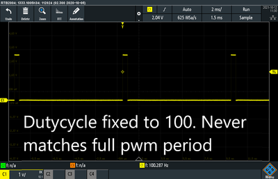

Hello everyone,
Working on an LPC55S06-EVK for future developments on LPC5506, I'm trying to output a 100Hz PWM with dutycycle change (following a gaussian curve). I'm using the example  "sctimer_pwm_with_dutycycle_change". It's working with the 24kHz pwm frequency but not with 100Hz (nor 1kHz). It never reaches 100% dutycycle (even if I pass 100 to the variable updatedDutycycle, see image below). As you can see in the video attached to this post, the pwm "jumps back" instead of going to full dutycyle.
You can find the code here : https://pastebin.com/BHBZC0hn .
Thanks for helping me.
François

francoisB
My application code is not the issue because when I try this code :
void SCTIMER_LED_HANDLER()
sctimerIsrFlag = true;
updatedDutycycle = 100;
if (SCTIMER_GetStatusFlags(SCT0) & (1 << eventNumberOutput))
/* Clear interrupt flag.*/
SCTIMER_ClearStatusFlags(SCT0, (1 << eventNumberOutput));
So the dutycycle is set to 100 (thus 100%), the issue is still there (as shown in the screenshot below).
Thanks for your reply.
François

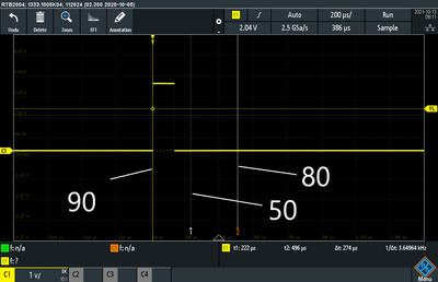

francoisB
I tried yesterday by setting updatedDutyCycle to 99 when it was 100, did not work.
Then I just tried to force it to 99 as you asked but the issue's still there.
Could it be a clock issue ?
Edit :
Something strange happens when I set dutycylcle to 99, the time to high is shorter than the time to high when I put 80.
13,939件の閲覧回数
francoisB
I did some measurements with my oscilloscope. You can see in the table below the time to high for different dutycycles :
dutycycletime to HIGH (µs)
1101
5501
10318
20635
30271
40587
50222
60539
70174
80491
90127
99343
100443
