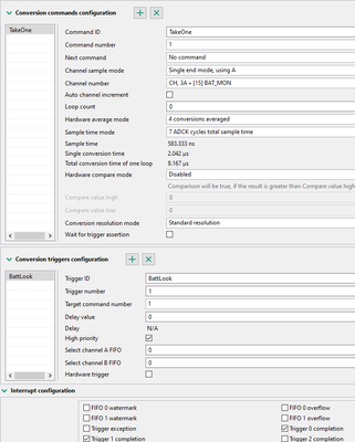

randylee
Contributor V
Interestingly enough, if I manually set some things:
/* Set conversion CMD configuration. */
// simpler configuration thing I think.
LPADC_GetDefaultConvCommandConfig(&mLpadcCommandConfigStruct);
mLpadcCommandConfigStruct.channelNumber = 3; // this is the pin we're on here
LPADC_SetConvCommandConfig(LPADC_BASE, ADC0_TAKEONE, &mLpadcCommandConfigStruct);
/* Set trigger configuration. */
LPADC_GetDefaultConvTriggerConfig(&mLpadcTriggerConfigStruct);
mLpadcTriggerConfigStruct.targetCommandId = ADC0_TAKEONE;
mLpadcTriggerConfigStruct.enableHardwareTrigger = false;
LPADC_SetConvTriggerConfig(LPADC_BASE, 0U, &mLpadcTriggerConfigStruct); /* Configurate the trigger0. */
(this taken from one of the examples) I then get a ISR but it can't get it to shut up (constant ISR).  Now these settings are the same as is in the peripheral.c file so I can only assume there is some order that isn't happening correctly to these.....

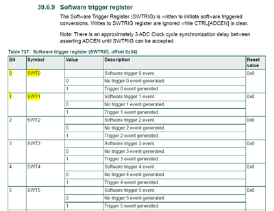

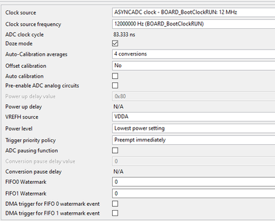

RaRo
Hello @randylee,
Looking at what you have done. In your init code, you are using LPADC_DoOffsetCalibration(LPADC_BASE) and LPADC_DoAutoCalibration(LPADC_BASE). Both of them were not previously added in your configuration trough ConfigTools, if you want them to be part of your code in peripherals.c, you should add them as follows:
[ConfigTools. Peripherals Tool. ADC0. General configuration.]
Also, you should do a previous configuration before and after the ADC configuration. Looking at the examples, and User Manual, you should do something similar to this after the ADC initialization:
while(1)
   LPADC_DoSoftwareTrigger(DEMO_LPADC_BASE, UM); /* UM is trigger mask, look at the following table for choose which trigger should be mask according your needs*/
   while (!g_LpadcConversionCompletedFlag)
   g_LpadcConversionCompletedFlag = false;
NOTE: This is for interrupt method.
[LPC55S1x/LPC551x User Manual. Chapter 39: LPC55S1x/LPC551x 16-bit ADC controller (ADC)]
Hope this helps.
Best regards, Raul.

randylee
Contributor V
this is one key thing that I've missed here; this idea that this isn't an index but a bitmap. The tools do not make this clear at all and I think I had it as an index. Moving that around helps some

RaRo
Hello @randylee,
Could you please tell me which SDK and version are you using?
Also, could you please try out the LPADC examples? Are they running as intended in your microcontroller?
Related with your polling method, is better if you use LPADC_Init instead of LPADC_Enable, LPADC_Init have a few steps more and includes the LPADC_Enable. Nonetheless, if this init code you are showing includes the ADC0 configuration trough ConfigTools, LPADC_Enable is not needed.
Do you want polling or interrupt method for work with the ADC? In polling the IRQ Handler, EnableIRQ and LPADC_EnableInterrupts are not needed nor used.
Regards, Raul.
