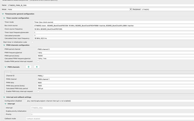

I'm using 4 wire fan, Power, ground, TACH, and PWM.
For PWM I'm using Ctimer2 Mat 3 in PWM mode.. Timer clock is 16MHz, PWM period is 1KHz, Duty cycled at 20%.
That's working as expected.

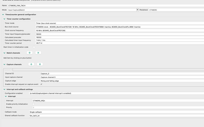

I Intend to use Ctimer0 in Capture Mode on channel 0 to count the fan rotations, and measure the RPM. What's the best way to do this, I have implemented it but it's behaving rather weirdly.
I've configured ctimer0 at 1KHz to count the fan signals (2 rising and 2 falling make a rotation)
const ctimer_config_t CTIMER0_FAN_TACH_config = {
  .mode = kCTIMER_TimerMode,
  .input = kCTIMER_Capture_0,
  .prescale = 15999
static void CTIMER0_FAN_TACH_init(void) {
  /* CTIMER0 peripheral initialization */
  CTIMER_Init(CTIMER0_FAN_TACH_PERIPHERAL, &CTIMER0_FAN_TACH_config);
  /* capture channel 0 of CTIMER0 peripheral initialization */
  CTIMER_SetupCapture(CTIMER0_FAN_TACH_PERIPHERAL, CTIMER0_FAN_TACH_CAPTURE_0_CHANNEL, kCTIMER_Capture_BothEdge, true);
  CTIMER_RegisterCallBack(CTIMER0_FAN_TACH_PERIPHERAL, CTIMER0_FAN_TACH_callback, kCTIMER_SingleCallback);
  /* Start the timer */
  CTIMER_StartTimer(CTIMER0_FAN_TACH_PERIPHERAL);
 I'm getting interrupts randomly, and they stop abruptly.
I get interrupts even without the fan connected. What am I missing ?
4,305 Views
amithrao
It was a hardware issue ! the signal on the tach pin wasn't pulled up.. adding a pull up resistor there to 3.3V solved the issue!

Thanks for the response.. Yes I'm using the second method, where the TACH signal is connected to the capture pin (not sure if it has to be a particular channel).. But as you can see, the initialization code above is how I've set it up..
void fan_tach_isr(uint32_t flags)
	static int8_t count = 1;
	uint8_t tc_read_count = 4; //4 poles for the fan = 1 rotation
	uint32_t tc = CTIMER_GetTimerCountValue(g_ctx.fanCtrlHandle.tach_ctimer_handle);
	if(++count > tc_read_count)
		//uint32_t tc = CTIMER_GetTimerCountValue(g_ctx.fanCtrlHandle.tach_ctimer_handle);
		g_ctx.fanCtrlHandle.rpm = (60000/tc);
		CTIMER_Reset(g_ctx.fanCtrlHandle.tach_ctimer_handle);
		LOG_DEBUG("ISR count = %d, TC = %ld RPM = %ld", count, tc, g_ctx.fanCtrlHandle.rpm);
		count = 1;
where tach_timer_handle is
The interrupts are firing only when I connect and disconnect, and they're weird.. as in the TC field in the handle keeps increasing even when the fan is disconnected - (this may be expected? )
and the interrupts don't fire when the fan is running after a few rounds.. not sure what's going on here! any ideas ?
Btw, I'm using Ctimer2 to control the PWM pin on the same fan.. The config for that looks like this:
and the corresponding Tach pin to ctimer0, and the config looks like this:
Does it look okay ? or am I missing something ?

xiangjun_rong
Can you estimate the TACH signal  frequency when the motor is running?
I suppose that the TACH signal  frequency is too high, the capture frequency is too high for the MCU to handle. The maximum ISR frequency is 1MHz I suppose for the lpc550x.
For your case, pls delete the line in the ISR:
Because the line requires long time, instead, you can save the tc to an array, in the debug, you can check the data in the array.
Can you use the method one? you can have the CTimer to count the edge of the capture signal if the TACH signal  frequency is very high, pls have a try.
