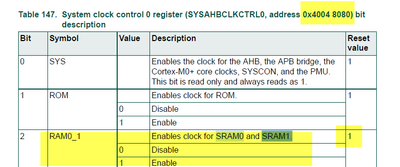

Hi. I trying to play with LPC845 and noticed a sample project in MCUXpresso writes 56 to 0x40000220. The LPC845 documentation says nothing about this memory location. Is something correct? Are there other registers that I could adjust? The memory map says the watchdog is located there, but it has no 0x0220 registers.

For LPC845, I think this code for enable SRAM is wrong. maybe this is just copy from other part, for example LPC546xx, enable SRAM register address is 0x40000220 as below:
For LPC845, address should be 0x4004 8080, while it enabled by default, so the demo also can work well, see below:
Hope it can help you.

Hi Alice, thank you for looking into this. This is what lpc845breakout_led_blinky says:
// Reset entry point for your code.
// Sets up a simple runtime environment and initializes the C/C++
// library.
__attribute__ ((section(".after_vectors.reset")))
void ResetISR(void) {
// Disable interrupts
__asm volatile ("cpsid i");
// Enable SRAM clock used by Stack
__asm volatile ("LDR R0, =0x40000220\n\t"
"MOV R1, #56\n\t"
"STR R1, [R0]");
3,228 Views
Hello loudpotato,
This address doesn't release on UM, from the comment, it shows // Enable SRAM clock used by Stac
this is no issue, the demo also can work well.
Alice

Hello loudpotato,
Sorry for my last comment.
