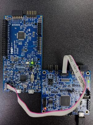

2.1 SWD debug
As a debugger, the most basic function of MCU Link Pro is debugging, and now commonly used is SWD debug. When you get the development board, you can see that there are three SWD interfaces on it. Only J7 is the SWD interface to debug target board. It is on the opposite side of the USB interface to facilitate the connection and debugging of the target board. The other two interfaces J3 and J11 are SWD interfaces of LPC55s69 and LPC804 respectively.
Another important function of this debugger is that it can supply power to the target board. The use method is to connect J6 with jumper, and 1.8V and 3.3V power supply can be selected through J5.
The specific connection is shown in the figure below:
- Connect the SWD interface of J7 and target board with debug line.
- J6 connecting jumper cap (supplying power to target board).
 The USB cable connects J1 and the computer, so you can debug with MCUXpresso IDE or other IDEs.

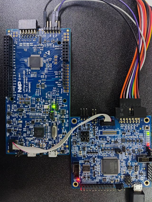

2.2 UART (VCOM) Usage
In the development and debug stage, users often need to print information through the serial port. Using MCU Link Pro, without additional hardware, directly connect the TX and Rx of target UART with the Rx / TX of UART of MCU Link Pro. Through the VCOM function, you can print information from the USB port to the serial port assistant at the PC end.
- J19-8 (purple line) connects UART TX of target board
- J19-9 (gray line) connects the UART RX of the target board
- J19-1 (GND) connect GND of target board
- J14 disconnected
- J6 plug in the jumper cap (supply power to the target board)

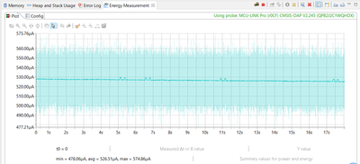

2.3 Energy measurement
The MCU Link Pro board contains a circuit that can measure the current or voltage of the target board, and it can be calibrated automatically every time it is powered on without manual intervention. There are two maximum measurement ranges for energy measurement. If the data is higher than the maximum range, the measurement result is inaccurate.
The two maximum measurement ranges are as follows, which need to be configured with J16, J17 and J18.
Energy measurement needs to be used with MCUXpresso IDE, and the results are displayed in the IDE interface. Use J9 port on the board.
- J9-1 connects the power supply end of the target board.
- J9-3 connects the chip ends of the target board.
- J9-2 connects the GND of the target board
For details on how to use the MCU Xpress IDE interface, please refer to:<MCUXpresso_IDE_Energy_Measurement.pdf>
3. Test result
The test results are as follows:
