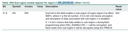

According to LPC55Sxx UM, each PRINCE region has its SR_ENABLEx register. This register enables PRINCE encryption and decryption of data for each sub-region of crypto region 0. Each bit in this field enables a sub-region of crypto region 0 at offset 8kB*n, where n is the bit number.  For example, when we set SR_ENABLE0=0X00000005, PRINCE region 0 sub-region 1 and sub-region 3 are set as encryption region. When read data out from these sub-regions, PRINCE will decrypt the data automatically.

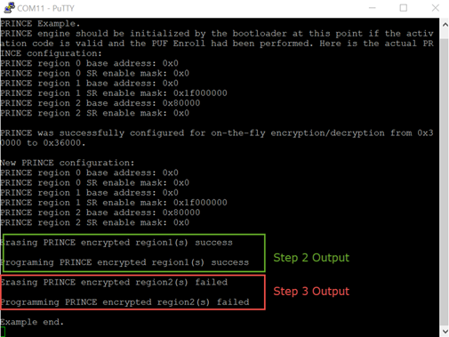

Step 2: Select two discontinuous sub-regions ( 0x30000-0x32000,0x34000-0x36000). Erase one of them (0x30000-0x32000), then write data to this sub-region.
Output: Erasing and Writing are all successful. See Figure 2.
//Erase 0x30000-0x32000 sub-region
status=PRINCE_FlashEraseWithChecker(&flashInstance,0x30000,0x2000,kFLASH_ApiEraseKey);
//Write 0x30000-0x32000 sub-region
status=PRINCE_FlashProgramWithChecker(&flashInstance,0x30000,(uint8_t *)prince_iv_code,0x2000);
Step 3: Erase and Write the other sub-region ( 0x34000-0x36000 )
Output: Erasing and Writing are failed. See Figure 2.
//Erasing 0x34000-0x36000 sub-region
status=PRINCE_FlashEraseWithChecker(&flashInstance,0x34000, 0x2000,kFLASH_ApiEraseKey);
//Write 0x34000-0x36000 sub-region
status=PRINCE_FlashProgramWithChecker(&flashInstance,0x34000, (uint8_t *)prince_iv_code,0x2000);
  1. Error Analysis
According to UM11126(49.16.1 Functional details), each crypto region has its own SKEY and IV code. SKEY and IV are used together by the PRINCE when encrypting or decrypting the data in the sub-regions of crypto region.
For Instance, For PRINCE region1, each time after we execute erasing operation, new Skey1 and IV1 are generated, thus when executing erase/read/write operation to another sub-region, the old IV1 and new IV1 don’t match, which causes PRINCE can’t decrypt correctly.
