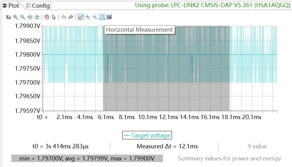

Select the target voltage to be measured, and click the button to run the Energy Measurement interface. You can see the slight fluctuation of voltage in the plot interface and view the average voltage through the delimited area of horizontal measurement, as follows:
Fig.3

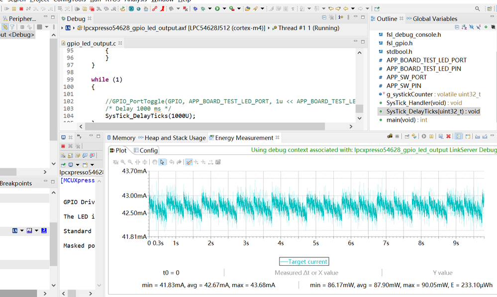

2.2 Use in Debug state
When used in the debug state, you can use MCUXpresso IDE or KEIL to enter the debugging state. Click the button on the energy measurement interface to read the power consumption in the debug state. The measurement process is the same as the non-Debug state, as follows:
Fig.5
