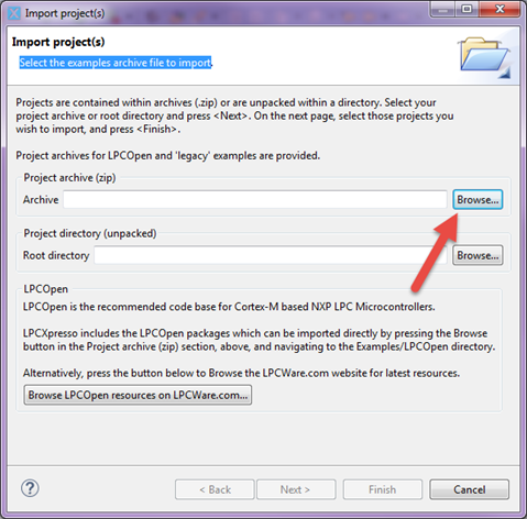

1. Click on Import project(s).
2. Select the examples archive file to import. In this case, the projects imported are contained within archives .zip.
3. For this example the LPC11U14 LPCXpresso board is selected. Click Open. Then click Next
4. Select only the LPCOpen Chip Library and LPCOpen Board Library Project. Click Finish.

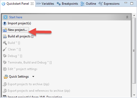

1. In Quickstar Panel, click "New project"

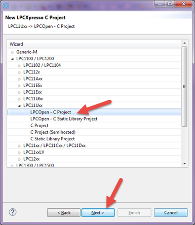

2. Choose a wizard for your MCU. In this case LPC1100/LPC1200 -> LPC11Uxx -> LPCOpen-C Project
This option will link the C project to LPCOpen. Then click Next.

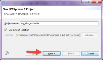

3. Select the Project name and click Next.

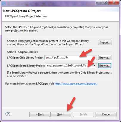

5. Select the LPCOpen Chip Library and LPCOpen Board Library, these projects must be present in the workspace.

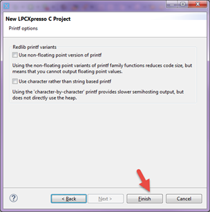

6. You can set the following option as default clicking Next, then click Finish.
