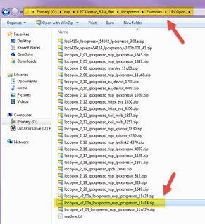

After install LPCXpresso, the LPCOpen packages for supported board(s)/device(s) can be found at the path:
<install_path>\lpcxpresso\Examples\LPCOpen >
This directory contains a number of LPCOpen software bundles for use with the LPCXpresso IDE and a variety of development boards.
Note that LPCOpen bundles are periodically updated, and additional bundles are released. Thus we would always recommend checking the LPCOpen pages to ensure that you are using the latest versions.
This example was created using the LPC11U24 LPCXpresso board in this case the drivers selected is lpcopen_v2_00a_lpcxpresso_nxp_lpcxpresso_11u14.zip

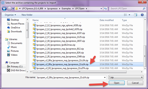

In order to create a new project, it is necessary to first import the LPCOpen Chip Library for the device used and optionally the LPCOpen Board Library Project. For do that it is necessary to follow these steps:
1. Click on Import project(s).
2. Select the examples archive file to import. In this case, the projects imported are contained within archives .zip.
3. For this example the LPC11U14 LPCXpresso board is selected. Click Open. Then click Next
4. Select only the LPCOpen Chip Library and LPCOpen Board Library Project. Click Finish.
The same steps are required for any LPC device and board you are used.

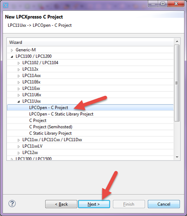

1. In Quickstar Panel, click "New project"
2. Choose a wizard for your MCU. In this case LPC1100/LPC1200 -> LPC11Uxx -> LPCOpen-C Project
This option will link the C project to LPCOpen. Then click Next.

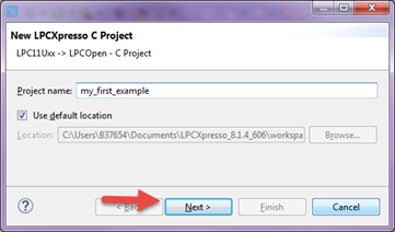

3. Select the Project name and click Next.

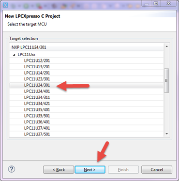

4. Select the device used (LPC11U24 for this case) and click Next.

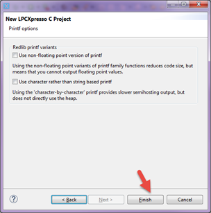

5. Select the LPCOpen Chip Library and LPCOpen Board Library, these projects must be present in the workspace.
6. You can set the following option as default clicking Next, then click Finish.
7. At this point, a new project was created. This project has a src (source) folder, the src folder contains:
cr_startup_lpc11uxx.c: This is the LPC11Uxx Microcontroller Startup code for use with LPCXpresso IDE.
crp.c: Source file to create CRP word expected by LPCXpresso IDE linker.
sysinit.c: Common SystemInit function for LPC11xx chips.
<name of project> my_first_example: This file contains the main code.
8. LPCXpresso creates a simple C project where it is reading the clock settings and update the system core clock variable, initialized the board and set the LED to the state of "On".
9. At this point you should be able to build and debug this project.
