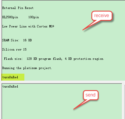

I'm working on a project which contain a part in which I need to get a string that contains command (or just text) from the PC (working on visual studio environment).
The problem is that once I send a string from the computer such as "turnOnRed", the KL25z is  not receiving all the string (I trying to  keep it  in char array)- sometimes it receiving one letter and sometimes it even get all string  such as "delay
5000"
I using codewarrior, and in order to get the string i'm using the following command
char temp=uart_getchar (UART0_BASE_PTR); //it's waiting until data is at UART0_data register
temp is going to char array in case it's suitable (very short code).
the command is  in a while function for multi reading.
note that if i send characters one by one it's working fine.
the problem (as I see it) is that the computer sends the string at once, and it the uart is not suitable for this kind of work, it doesn't have large FIFO buffer or something like that .
what solution can be to such thing?
Moreover, I need to send large text files and DMA should be suitable for it (I think), what configurations are needed for that? and will I face the same problem which I had in the normal use of UART.

Hi Ofir,
   Do you have tried this code:
https://www.nxp.com/downloads/en/lab-test-software/KL25_SC.exe
  This code platinum_freedom project can send the received the UART data back to PC, this is my test result:
You can find when received the trunOnRed, the KL25 will send it back to PC, you can find all the PC data is received.
You can try it.
Actually, this code is :
    while(1)
        ch = in_char();
        out_char(ch);
It receves one byte data then send it back.
If you want to receve all the PC UART data directly, you also can use the UART interrupt and associated with the IDLE line detect function.
Wish it helps you!
If you still have question about it, please kindly let me know!
Kerry
