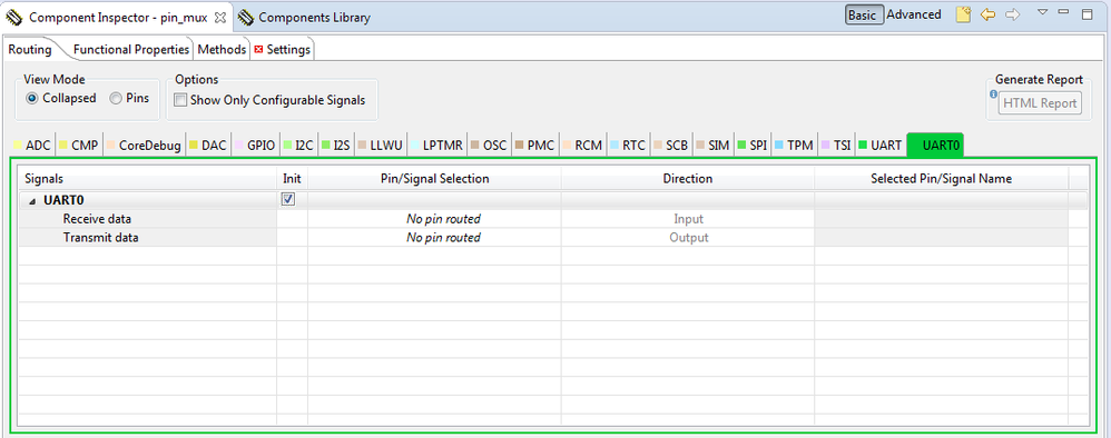

I'm working on KL16Z128 with KSDK_1.2.0 and PEx. But I can't find driver for UART0 when I config components using PEx. Who can tell me why? Is there something I missed? What's the right way to use UART0?
Thanks.

Hi Yang
There are two tabs for uart config. One is UART,  you can config UART1 and UART2
The other tab is specifically for uart 0, please see pictures below.

hengguangyang
Thank you Daniel.
I got the reason now. The UART0 is seperated from UART1/2. And furtherly, the PEx component for UART0 driver is LPSCI, not UART. That confused me before.
