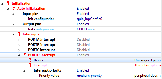

how to use the interrupt with fls_gpio?
I want to use this pin as interrupt so i put :
but i have this error
and i can't select any device. Why? There is an example?

Hello Daniele,
you forget to say important details as
  • what MCU are you using?
  • do you use KDS? which version?
  • which KSDK version?
This can be caused by reserved pin.
I created the example for you, it is for FRDM-K64F with component fsl_gpio with the SW2 interrupt.
Maybe it can help you, maybe not.
Please, let me know.
Iva

i'm using the kl46 with KDS3.0 and KSDK 1.2.
Thanks for the sample, i watch where i'm wrong.
