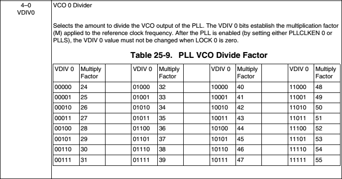

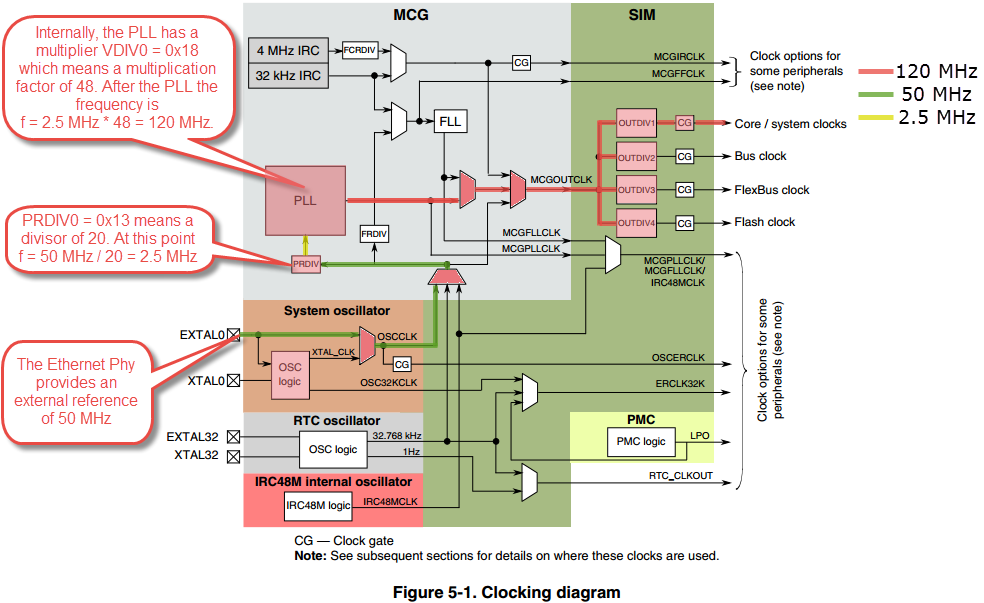

Hi, I want to change the K64F system clock to 100MHz. What files should I change to do it? I am using KDS3.0+KSDK1.2.0 without PE.

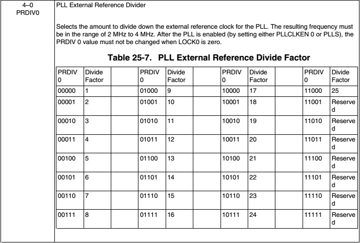

The FRDM-K64F contains an external reference of 50 MHz provided by the Ethernet Phy which is used to feed the MCU. As you can see in the image below it is divided by a factor which usually is configured as PRDIV = 0x13 to divide the external reference clock by a factor of 20 to feed the PLL with a 2.5 MHz signal. The PLL internally multiplies the frequency by a factor defined by VDIV0 which usually is configured as 0x18 to multiply by a factor of 48 to get 120 MHz. Since you want a 100 MHz output you need to modify this factor to 40 to get that frequency so you need to configure VDIV0 = 0x10.
So, what you need to do is to change that value in the KSDK configurations. In the file board.c is defined an structure called clock_manager_user_config_t g_defaultClockConfigRun which contains these configurations.

Change the value for the field vdiv to 0x10 and you will obtain a 100 MHz core clock.
