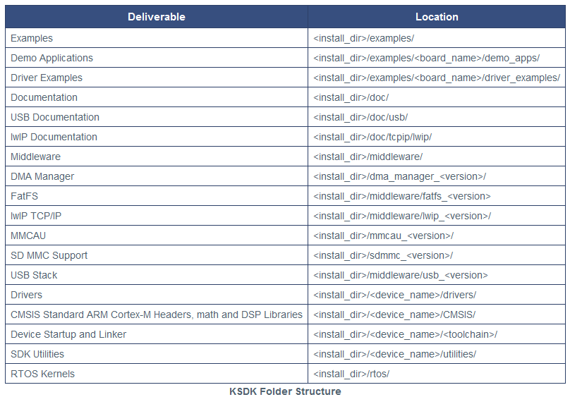

Hello Raul Cortes,
Please refer to this DOC to install ksdk2.0 about the FRDM-K64 board ,
How to: install KSDK 2.
then you will find the drivers and demos under the installation directory :
Hope it helps
