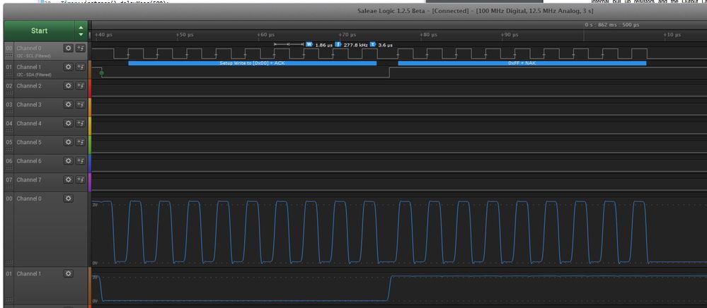

Now, I hooked up an analyzer to the I2C0 pins, and got this:
So there are a few questions about this:
1. The analyzer shows the clock is going at 277 kHz, not 100 kHz. Am I using the right clock in I2C_MasterInit?

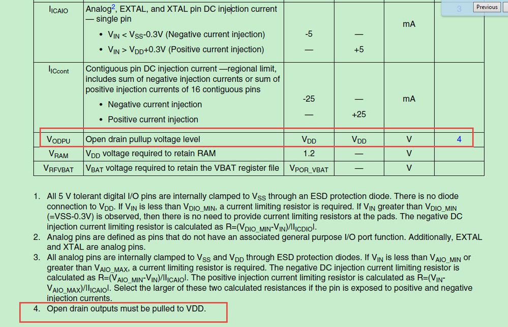

2. The analyzer shows the clock going between 0 and 3.something volts. But if I configured the ports as open drain, and the backpack has a 4.7k pullup to 5v, why isn't the output going to 5v?

Thanks for pointing out that note. I wish there were an equivalent diagram of the output circuits in the datasheet. I think what's happening is there's a Zener diode between the output and VDD, so even if I pull the output up to 5V, it gets clamped to VDD. I have some level shifters on order, that will make the bus 3v3 compliant on the K64 side, and 5v compliant on the backpack side.
As for the analyzer, the waveform you see is the very first activity on the i2c lines, so that should be the START signal. I suspect that the 3v3 logic high output is not enough to trigger the 5v backpack side. Hopefully the level shifter will help.

2. If you check the K64 datasheet, you will find the open drain pullup voltage leave is VDD, the vdd is 1.771-3.6V, so it can't be pull up to 5V.

4. When you use the I2C_MasterStart, did you use the analyzer check the wave, whether the I2C send the START signal in the I2C bus or not?
I2C_MasterStart is used to initiate a new master mode transfer by sending the START signal.
Besides, when you use this function, did you do the stop in the bus before? If the STOP signal never happens, then the START send again, the bus may be busy.
