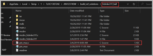

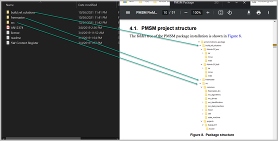

Hi, all
I am looking "PMSM Field-Oriented Control on FRDMKV31F with Hall and Encoder Sensors(Doc No. AN12374)" now.
In that, "PMSM Package" appears. I followed them but I didn't get the same file or folder.
How and where can I get them? also, how can I check code and pinmap?
Thanks,.

Hi @Frogram
I hope that you are doing well!
The AN12374 comes with associated software that it needs to be installed in windows using an exe.  Please download and install >AN12374SW
If I understood properly your first question. In the path selected for the installation of the software , there are sub-folders corresponding to what the AN mentions as PMSM package structure.
Regarding your second question about the  pin map.
There is a file called pin_mux.c , where you can consult the pins that are initialized for the projects of the AN.
Note: To get the pin_mux file you will need to install the AN SW.
I hope this could help you.
