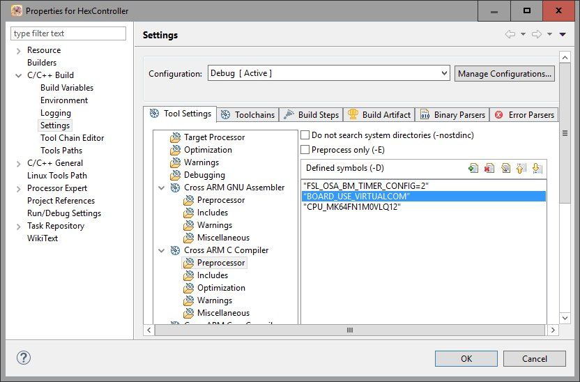

Hi, I've been trying to follow the blog post https://centaurian.co.uk/2015/12/23/ksdk-usb-cdc-printf/
to set up the USB interface on our K64 board as a CDC device, but hit a problem when defining the symbol “BOARD_USE_VIRTUALCOM” under the properties of the project “C/C++ Build >> Settings >> Cross ARM C Compiler >> Preprocessor”
Setting this gives me a compile error I can't work out,
<command-line>:0:1: error: macro names must be identifiers
Static_Code/System/subdir.mk:21: recipe for target 'Static_Code/System/PE_low_level_init.o' failed
make: *** [Static_Code/System/PE_low_level_init.o] Error 1
Removing the symbol stops the compile error but the usb device isn't detected by windows correctly, showing up in device manager as
Unknown USB Device (Device Descriptor Request Failed)
Any ideas where I might be going wrong?

In the end I had to uninstall the Design suite and reinstall as I had several version of the sdk and KDS installed which must of been confusing things. Starting from scratch everything worked fine.

Hi Ian,
I tested the procedure on my side and it works without problems.
Please, do you work with KSDK 1.3 or older KSDK 1.2 ? Do you have correctly installed KSDK into KDS? KDS User Guide page 63
Please, do you have included all files to your project?
After setting PE, did you generate the code?
Do you have added line “DbgConsole_Init(BOARD_DEBUG_UART_INSTANCE, DEBUG_UART_BAUD, kDebugConsoleUSBCDC);” to your source code? (main.c)
Did you set cdc_config.board_init_callback.callback on NULL ?
If you will attach your project here, I could check it.

Hi Iva, thanks for the suggestions.
It's with KSDK 1.3 and KDS version 3.2.0 with sdk eclipse_update installed.
After configuring each PE component I did generate the code.
And I've set the cdc_config.board_init_callback.callback to NULL
I've attached the project. Thank you for taking a look.
